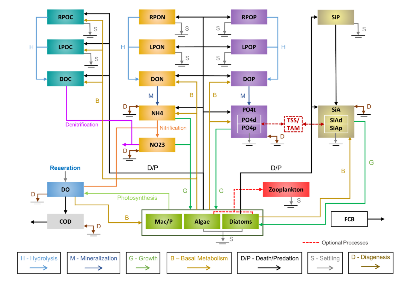

In EFDC+, the eutrophication module refers to modeling aquatic plants and algae, zooplankton, and the biochemical transformation of nutrients during this process. The kinetic processes included in the EFDC+ eutrophication module are derived from the CE-QUAL-ICM (or ICM) water quality model. This blog post describes significant changes in this module that include bug fixes and new features.
The schematic representation of the coupling between the water quality components is shown in Figure 1 (adapted from ICM). The complete set of state variables in the EFDC+ water quality module is provided in Table 1. In a recent code review, we discovered that in EFDC+ 10.3 and before:
  1. RPOC did not hydrolyze to DOC, and it consumed DOX as a function of the hydrolysis rate.
  2. RPOP did not hydrolyze to DOP, instead it converted directly to PO4t;
  3. RPON did not hydrolyze to DON, instead it converted directly to NH3;
Figure 1: Schematic diagram of water quality model structure in EEMS 10.4.
For consistency with the EFDC theory, the hydrolysis process was updated in EFDC+ 10.4, as shown in Figure 1. As a result, the users may obtain different results of some organic components compared to EFDC+ 10.3 as higher concentrations of DOC, DOP, DON, DOX, and lower concentrations of PO4t and NH3 are expected.
