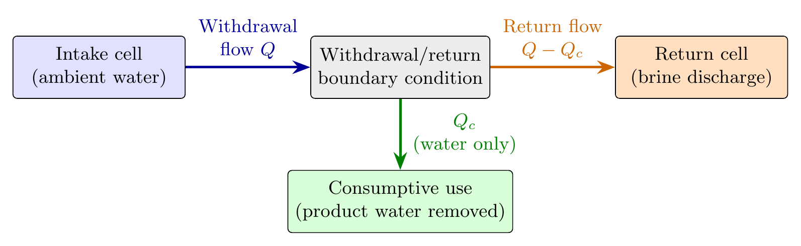

The withdrawal/return boundary condition now accepts a signed discharge modifier that adjusts the flow leaving the return cell.
  • Negative removes flow from the return cell. Volume leaves, constituent mass stays, so concentration goes up. This is the consumptive-use case: product water extracted, rejected salt left behind in the brine.
  • Positive adds flow out of the return cell, which drives concentration down. This covers dilution water, blended outfalls, and supplemental return streams.
The dissolved constituent mass taken in at the intake is preserved in full, and EFDC+ recomputes the discharge concentration automatically from that conservation. You do not prescribe the brine concentration; the model derives it.
A negative discharge modifier removes a water-only consumptive flow from the return cell, so the conserved constituent mass leaves in a smaller volume as concentrated brine.

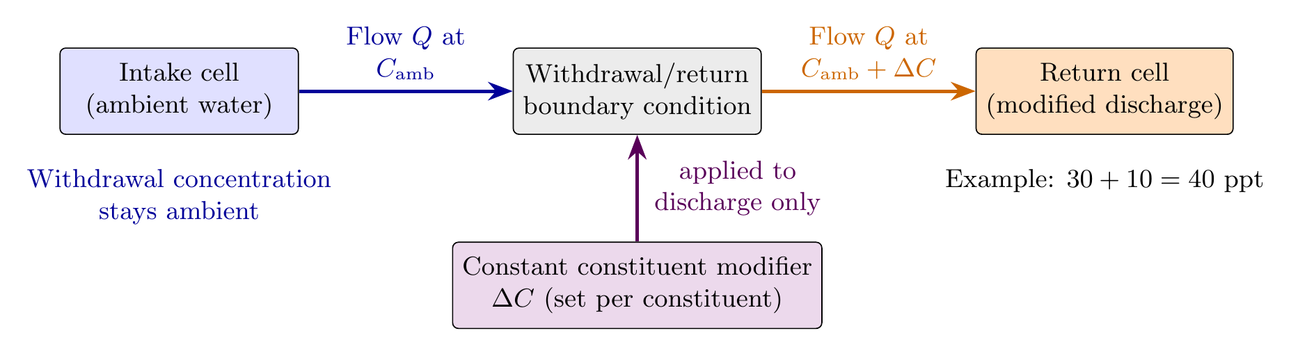

Constant constituent modifiers
Separately, you can apply a constant offset that adds to or subtracts from the discharge concentration on a per-constituent basis. The withdrawal concentration always remains the instantaneous ambient concentration at the intake cell, regardless of the modifier. For example, an intake drawing 30 ppt water with a +10 ppt salinity modifier discharges at 40 ppt if no other discharge modifiers were set.
A constant constituent modifier applies to the discharge only. The withdrawal concentration stays at the ambient intake value, while the return concentration is offset by a fixed per-constituent amount.

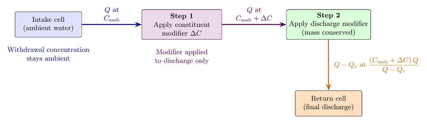

Order of operations
When both a constituent modifier and a discharge flow modifier are specified, EFDC+ applies the constituent modifier first, then adjusts the resulting discharge concentration for the change in flow.
Order of operations: the per-constituent modifier is applied first, then the discharge flow modifier adjusts the resulting concentration while conserving mass.

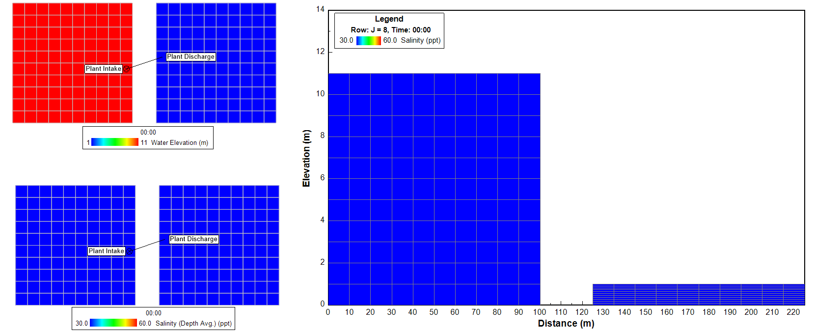

To verify the enhancement, we built a test case to show the discharge modifiers in action. The domain is two identical square basins, each 10 × 10 cells of 10 m × 10 m with 11 sigma layers. The two basins are separate except for a single withdrawal/return boundary condition connecting them. The plant intake draws from the left basin; the brine discharges to the right basin.
The initial water column depths are 11 m in the left basin and 1 m in the right basin, and salinity is a uniform 30 ppt everywhere. Intake is set at 1.1574 m³/s, equivalent to 10 m/day over the basin footprint, and the simulation runs for one day at a fixed 5-second time step.
The two-basin desalination test case: depth, water elevation, and salinity for the left and right basins, with the water-surface elevation profile across the domain.
Baseline, consumptive use disabled. The boundary condition acts as a pure transfer. Over one day the withdrawn volume moves from the left basin to the right, the water elevations effectively swap, and salinity stays pinned at 30 ppt in both basins. Water and salt move without artificial gain or loss.
