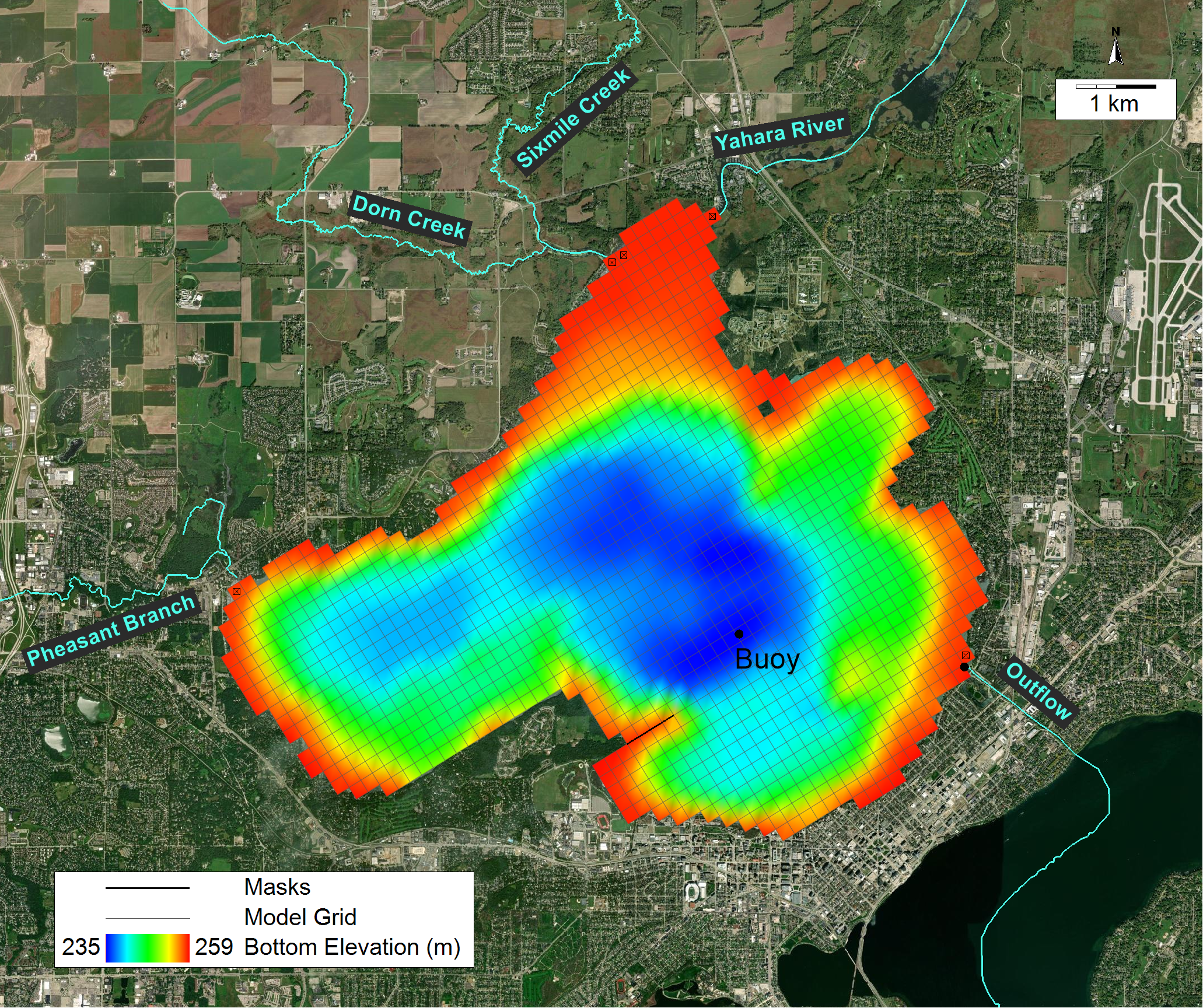

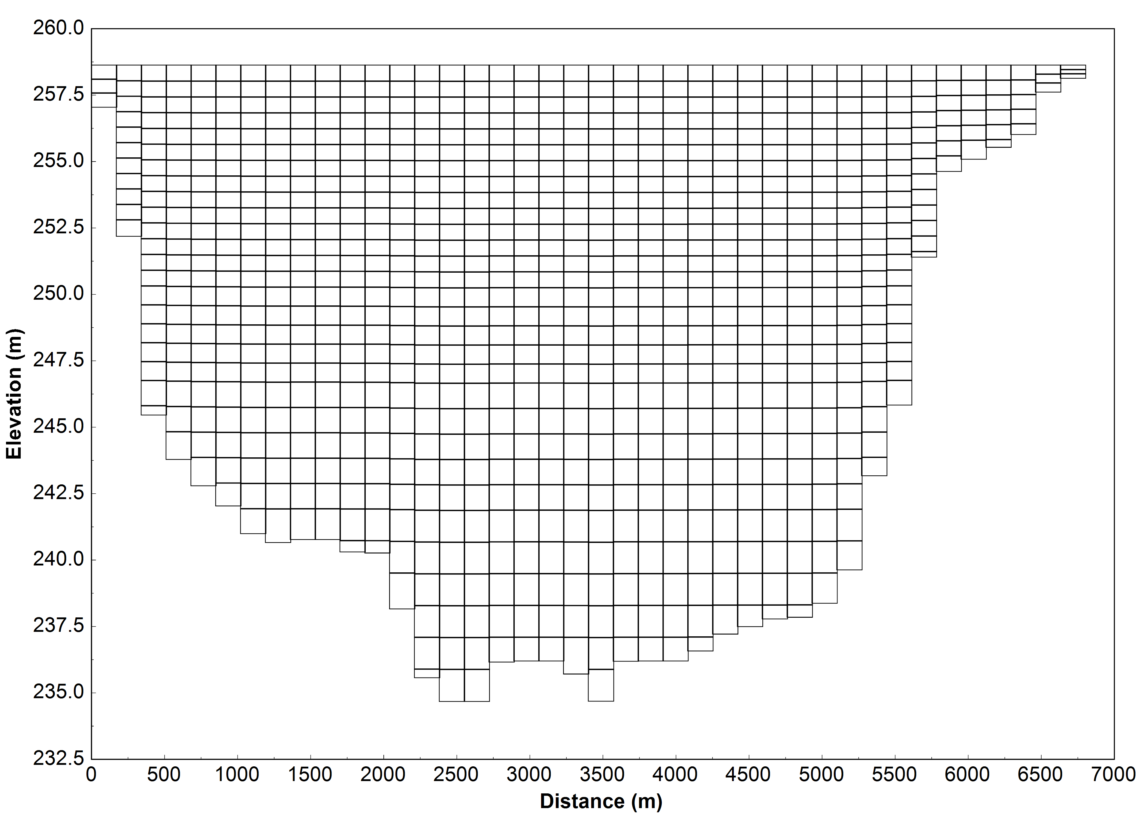

The model setup is preserved from the temperature simulation, using a high-resolution three-dimensional grid configured with 1405 horizontal cells and 30 vertical Sigma-Zed layers (Figure 1 and Figure 2). This vertical characterization allows the capture of detailed water column dynamics. The water quality simulation included two key biota groups – Diatoms and Cyanobacteria – representing primary phytoplankton communities. Sediment fluxes at the benthic boundary were assumed to be both spatially and temporally constant for model stability. The model runs for 5 years, from January 1st, 2017, through December 31st, 2022. The model’s numerical stability is also ensured by running with a fixed time step of 20 seconds for the hydrodynamic model and a kinetic step of 60 seconds for the water quality while the computational efficiency is optimized.
Figure 1. Northwest-Southeast vertical layering at Buoy
Figure 2. Horizontal grid, bottom elevation, and boundary conditions of Lake Mendota model.

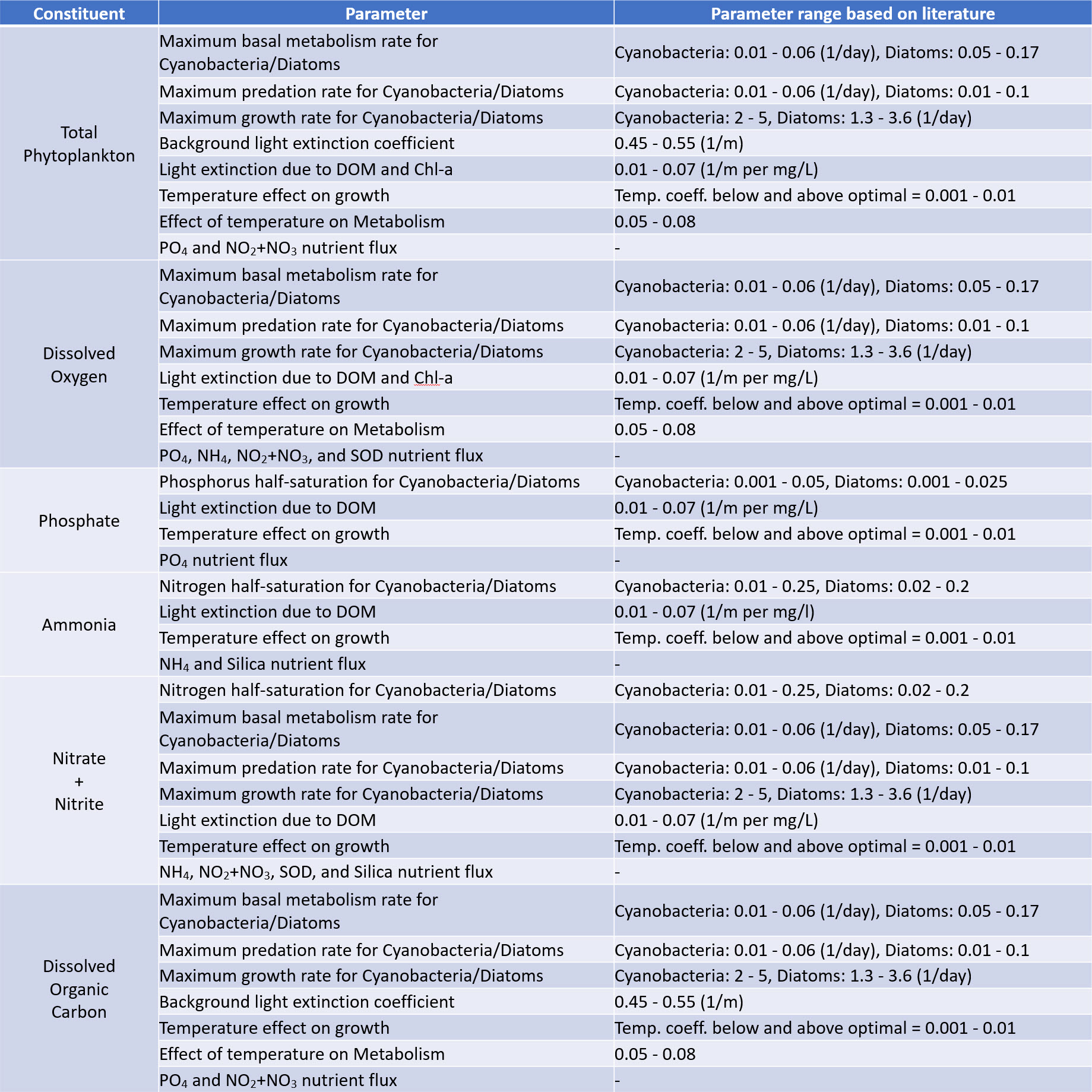

During the model calibration process, we focused on fitting the model output with observational data collected at the buoy that are openly accessible via the Environmental Data Initiative (EDI) portal. We also documented the model’s sensitivity to significant water quality parameters. The most sensitive parameters and their literature-based value range are tabulated in Table 1. Our observation is that the EFDC eutrophication model of Lake Mendota was most influenced by the phytoplankton-related parameters, including maximum growth rates, maximum basal metabolism rate, maximum predation rate, and temperature effects on growth.
Table 1. Sensitivity analysis results for Lake Mendota water quality calibration, presenting sensitive parameters by constituent with recommended parameter ranges

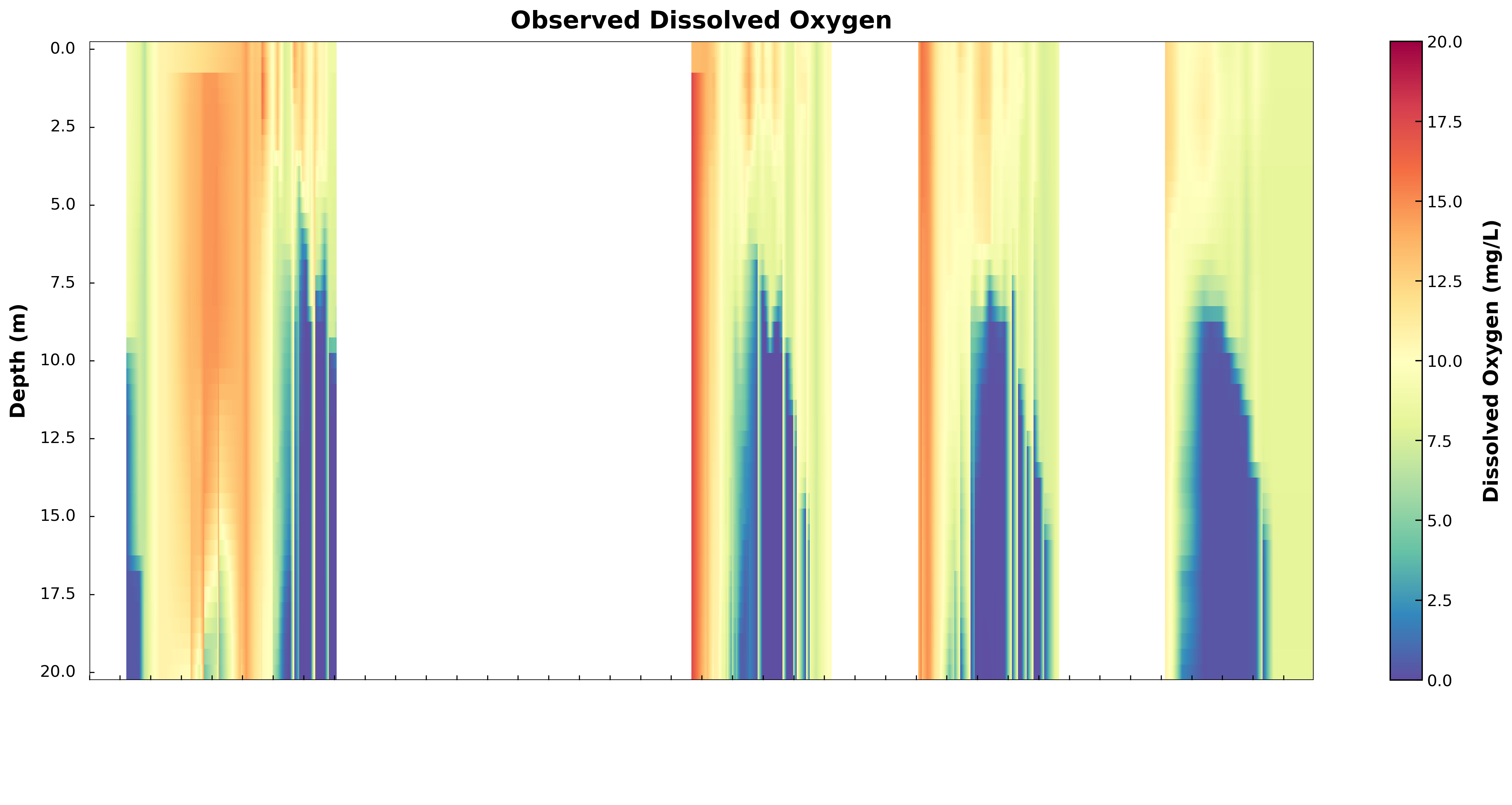

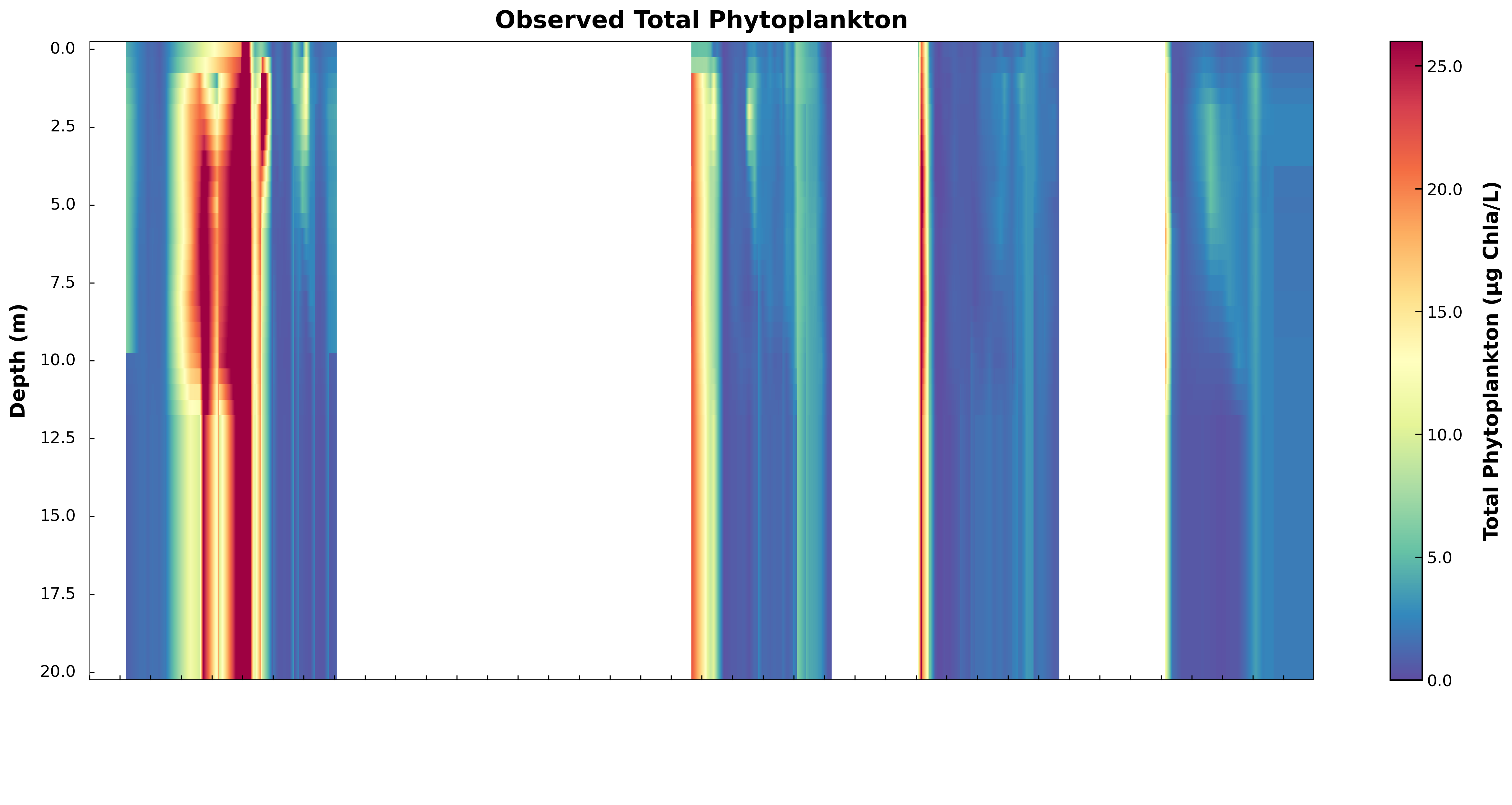

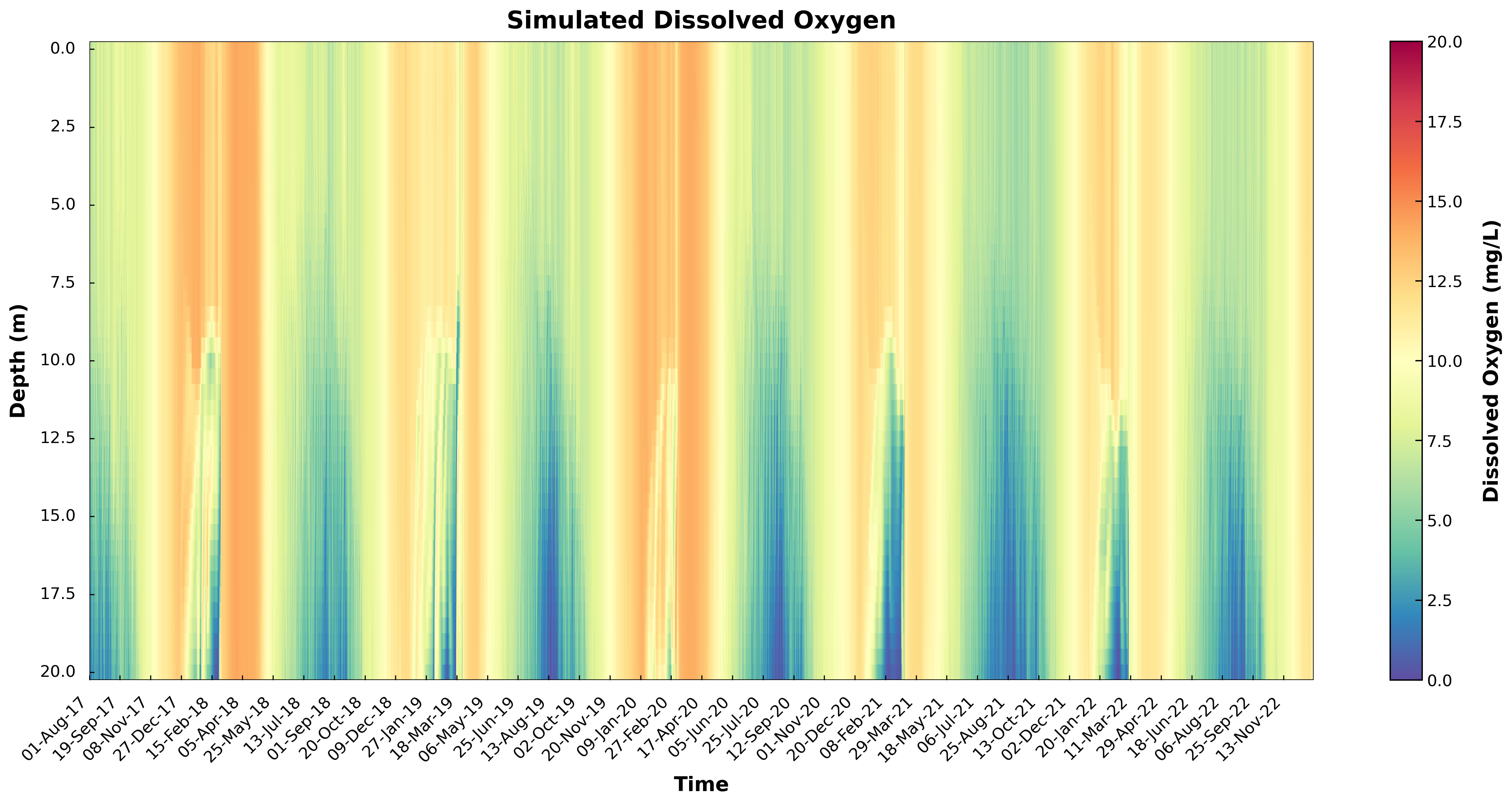

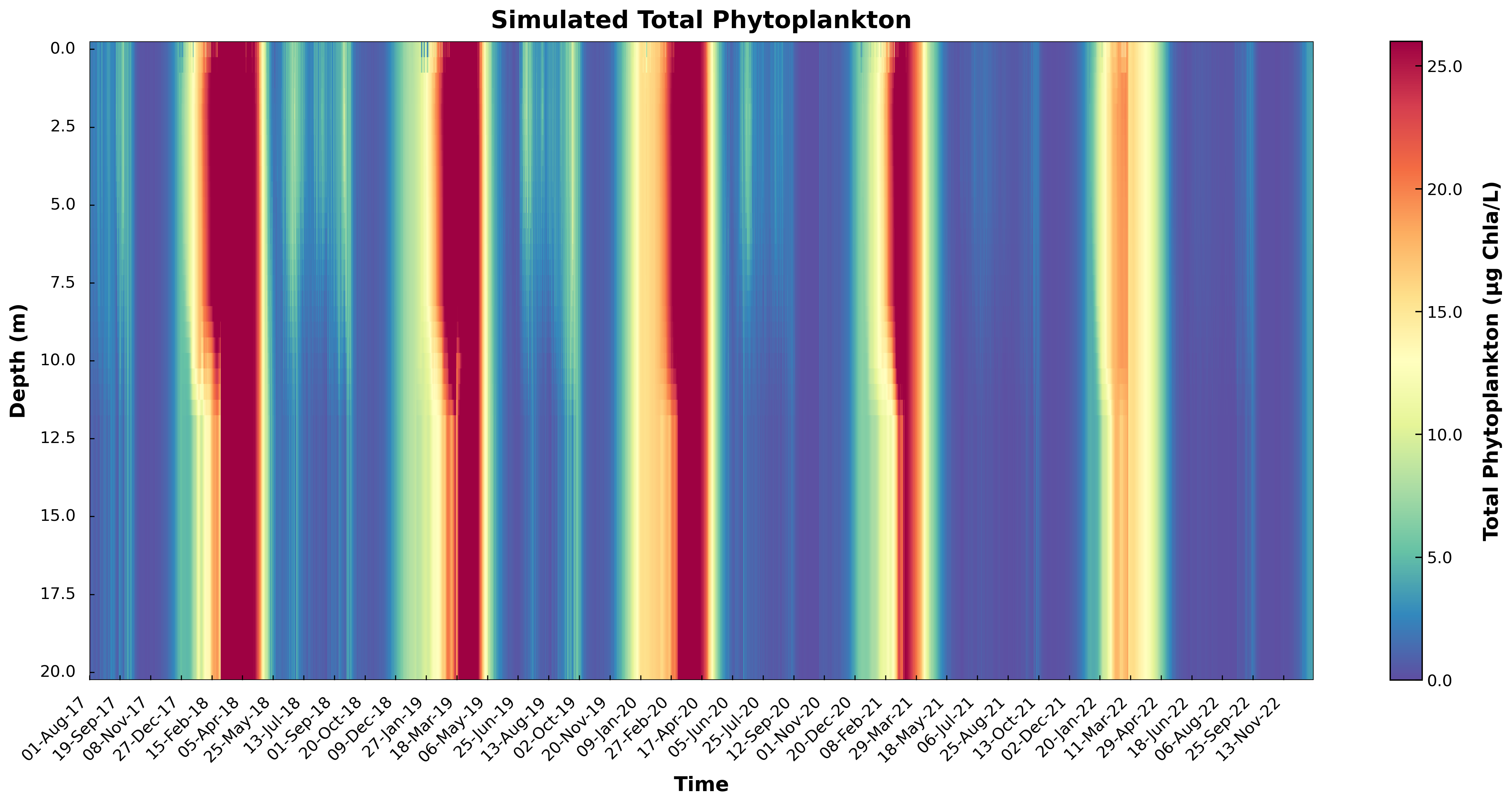

The model effectively reproduced key biogeochemical patterns observed in the water column, particularly the vertical stratification of dissolved oxygen and seasonal phytoplankton dynamics. Observations showed hypoxia developing in deeper layers during summer months, which is successfully captured by the model. The simulation also replicated surface-intensified phytoplankton blooms during warmer periods. This resulted in oxygen depletion at depth due to increased biological demand.

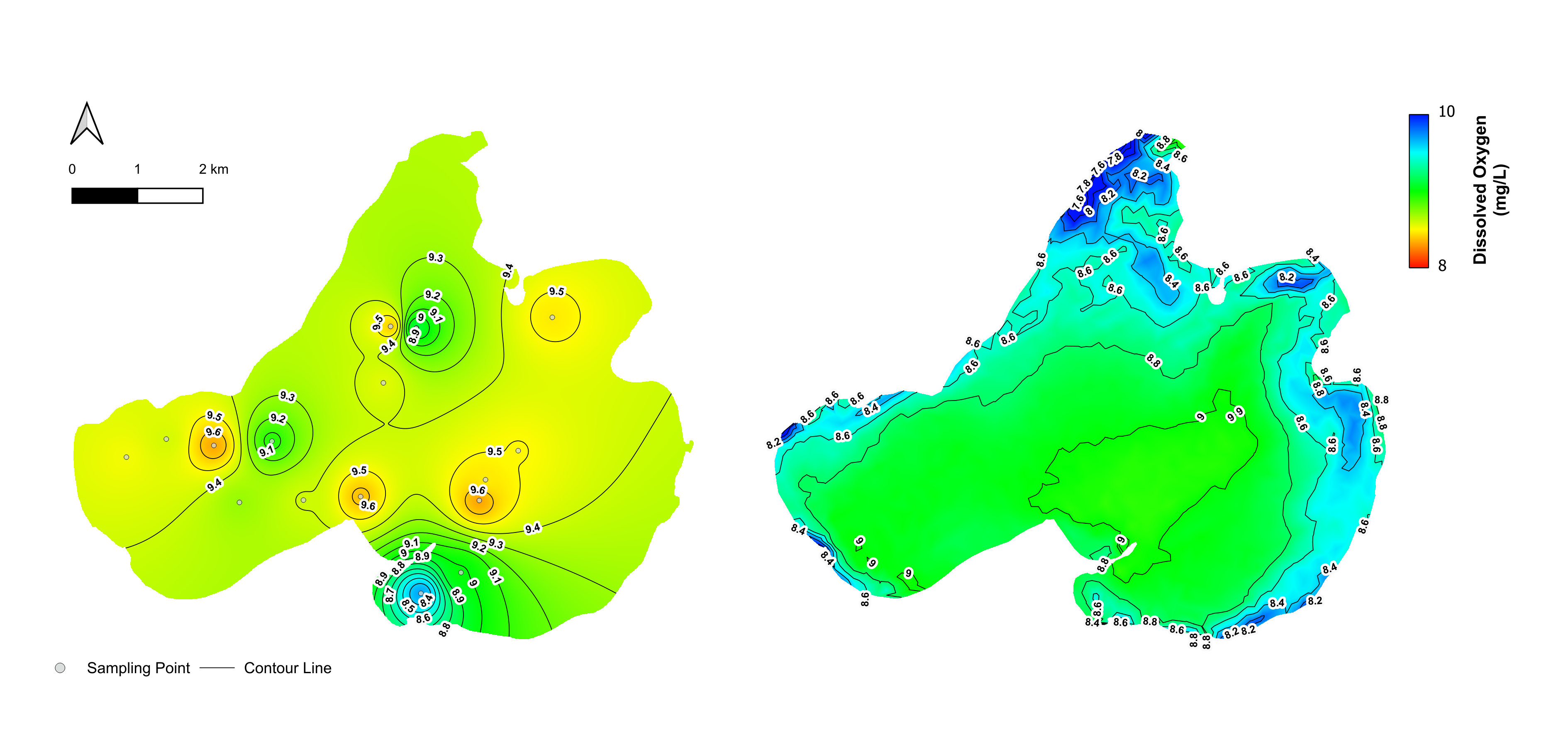

A comparison of observed and simulated data from August 2017 to December 2022 is shown in Figure 3, and the plan view of DO at the water surface is shown in Figure 4. This highlights the model’s capability to resolve temporal and spatial variability, despite some data scarcity and interpolation artifacts in the observational dataset.
Figure 3: Observed (top) and simulated (bottom) structures and temporal evolution of Dissolved Oxygen (left) and Total Phytoplankton (right) at the buoy, from August 2017 to December 2022. Missing hourly observations were interpolated, which may introduce artifacts.
Figure 4. Spatial distribution of observed and simulated Dissolved Oxygen at water surface

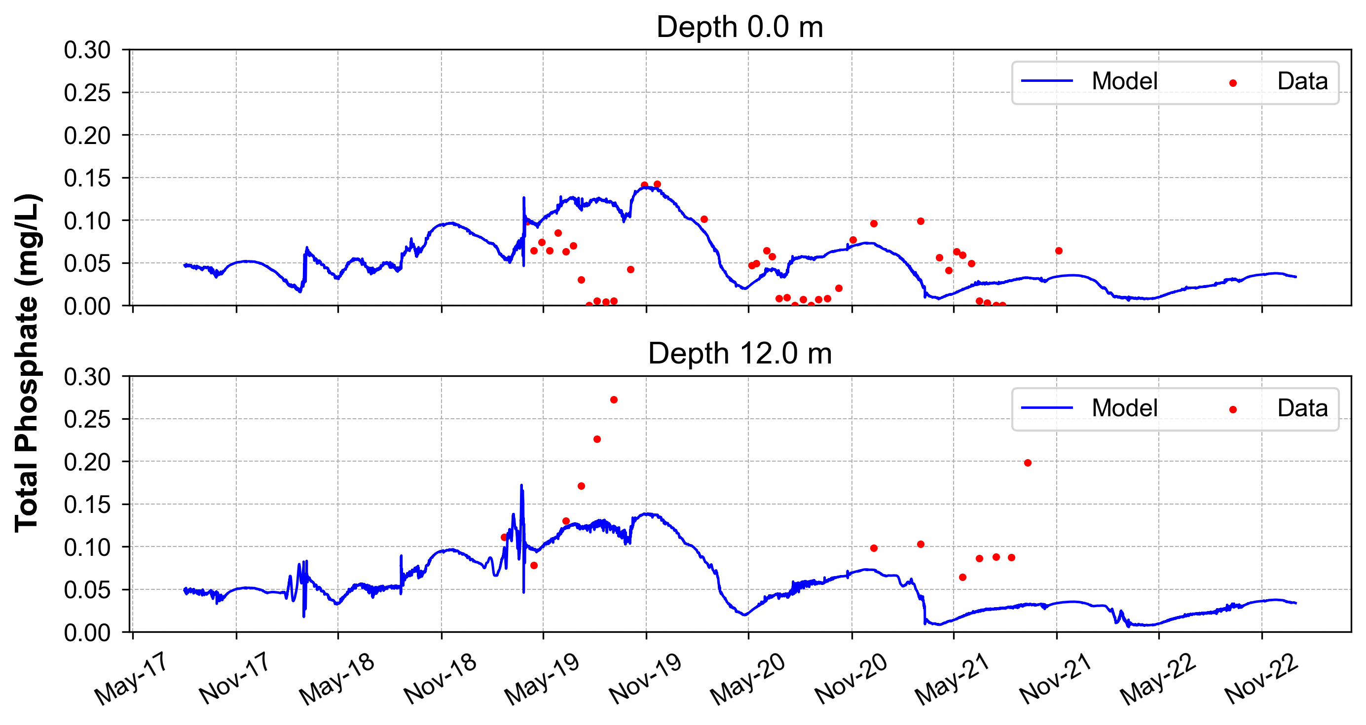

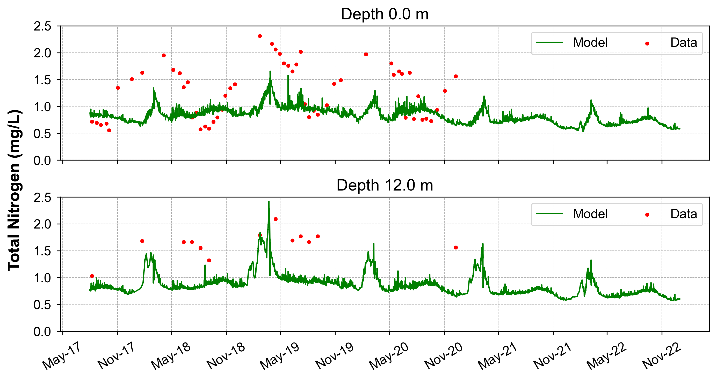

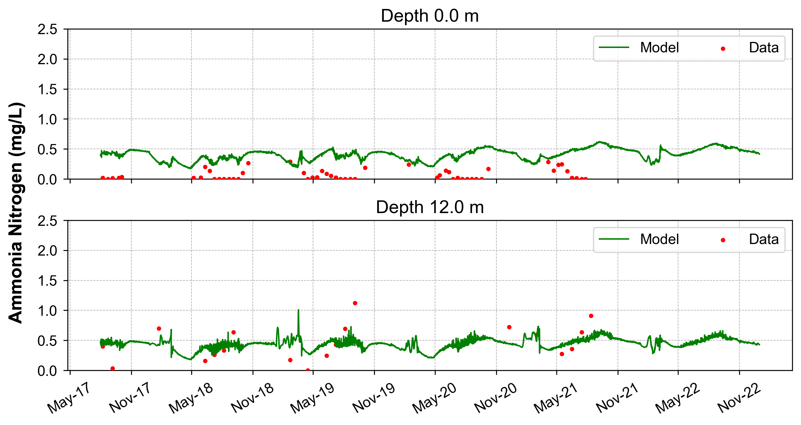

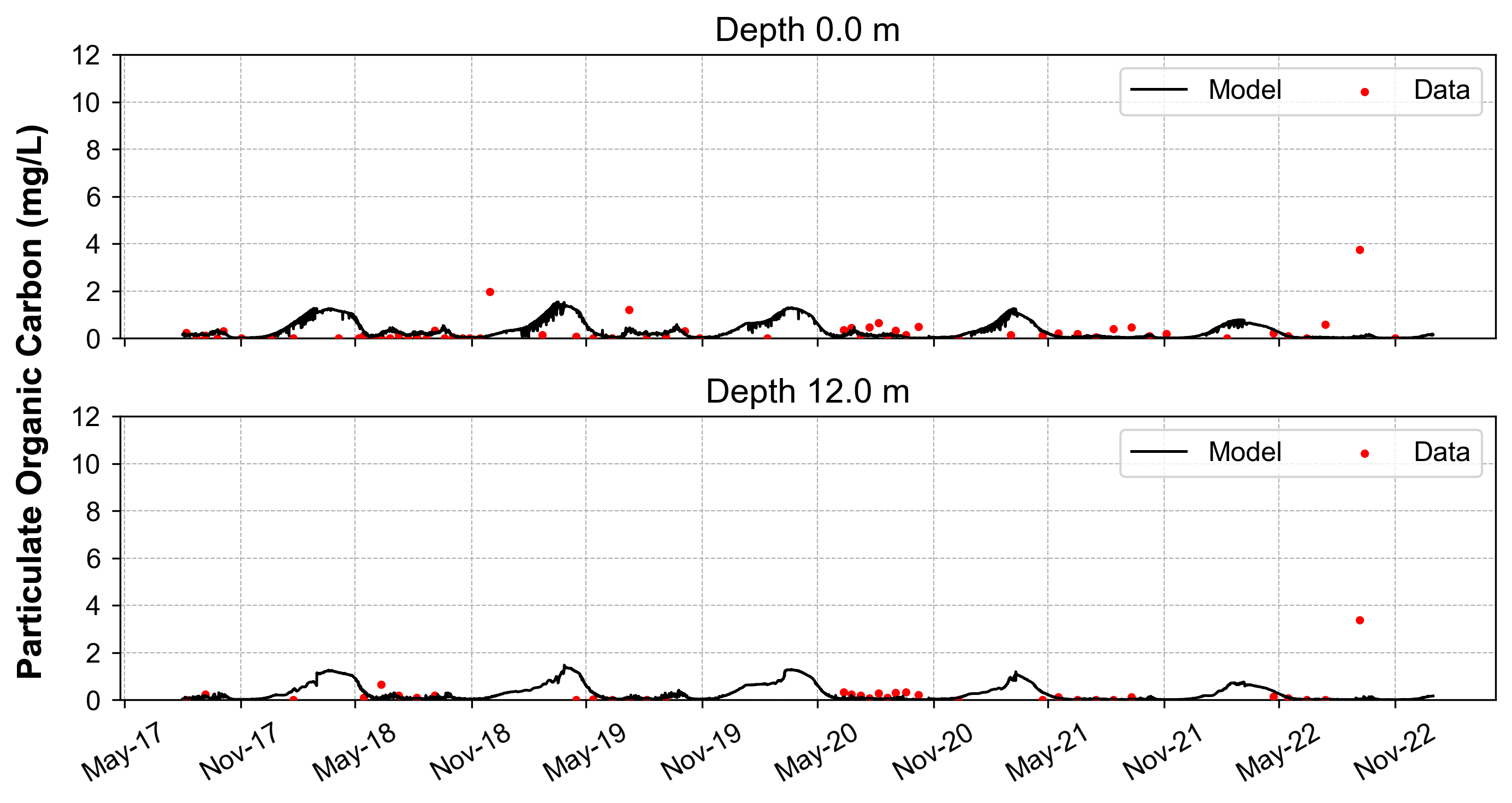

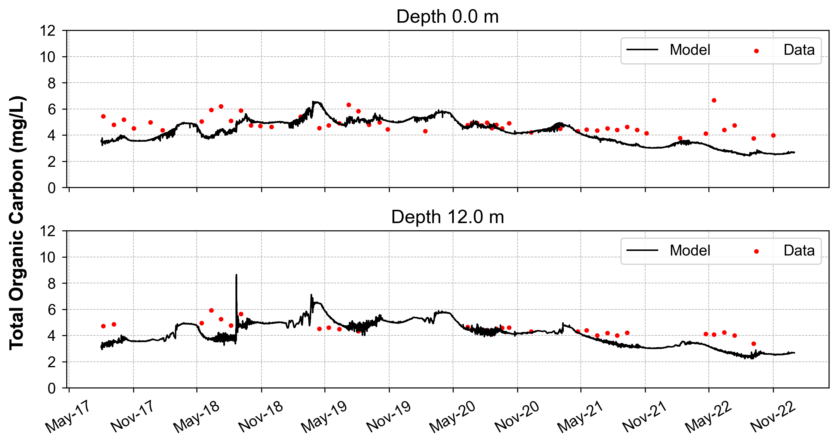

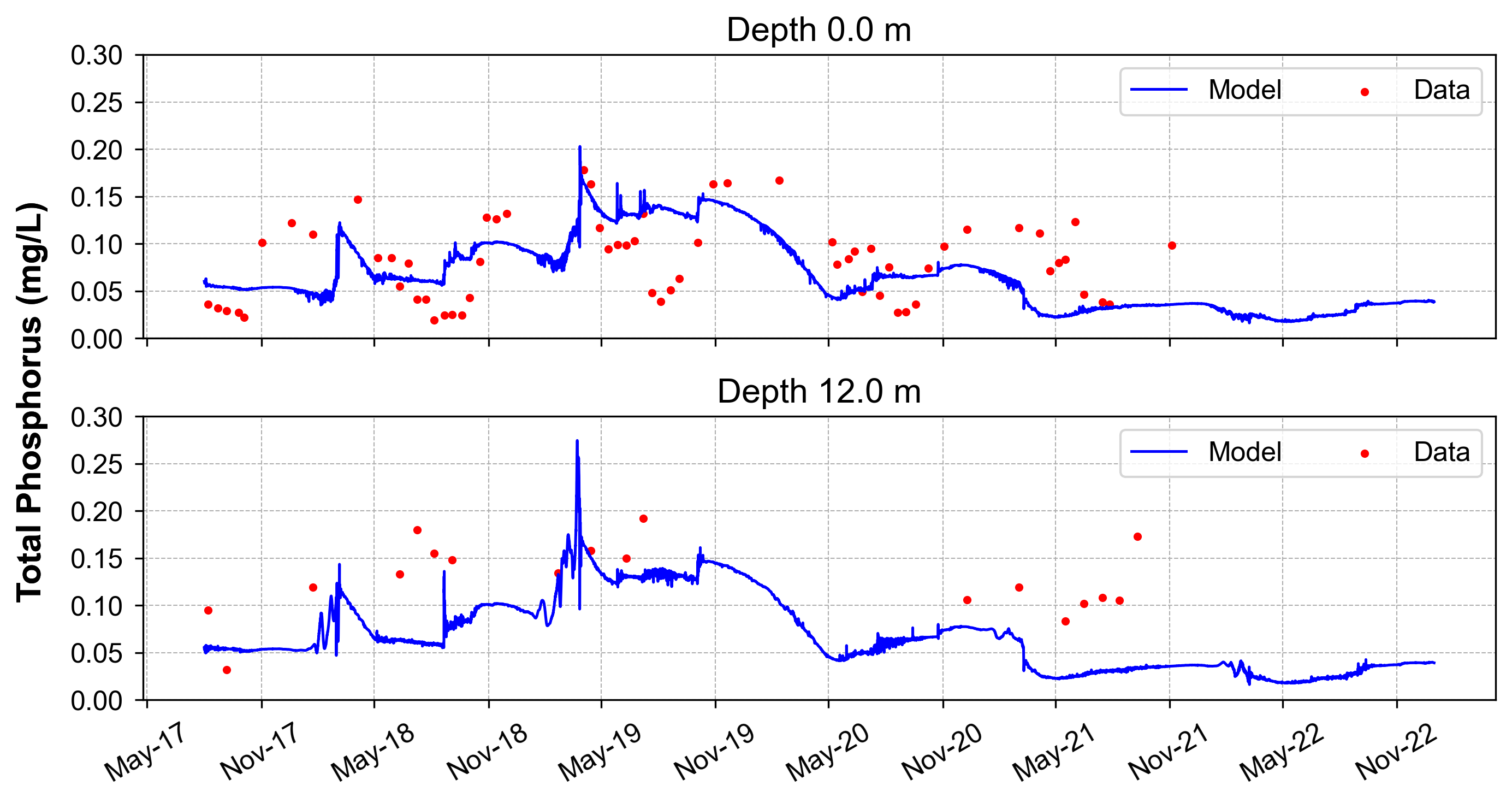

Model Calibration Results – Nutrients

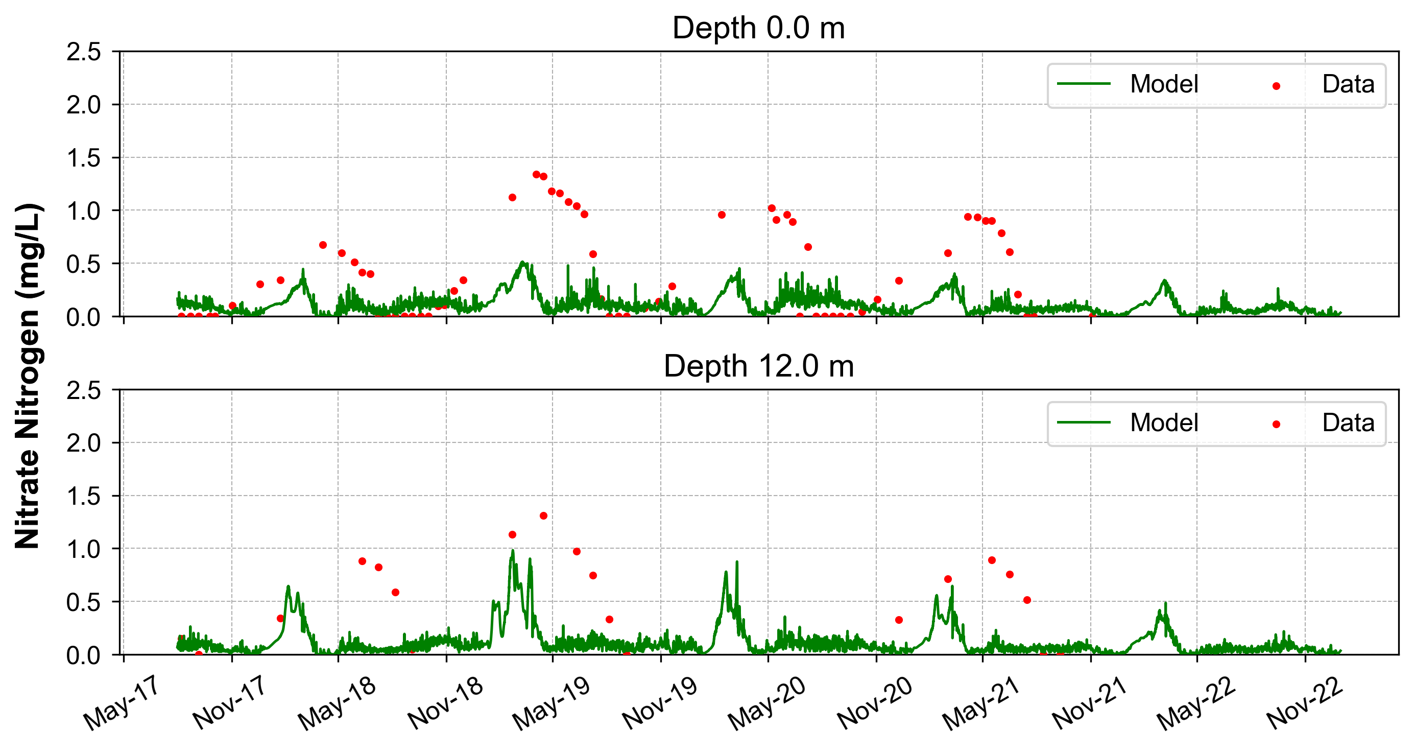

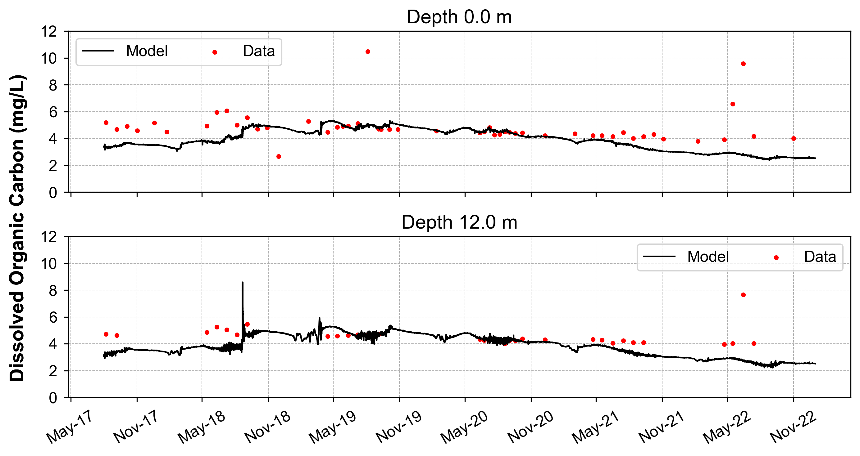

The model calibration for nutrients strongly aligns with observed seasonal trends, particularly during algal blooms when nutrient concentrations peaked (Figure 5). The nitrogen and phosphorus levels at 20 meters were underpredicted, likely due to the absence of sediment diagenesis processes in the model. Despite this, the model performed well in simulating dissolved organic carbon (DOC), capturing vertical trends with only minor deviations at greater depths during high-activity periods. Total organic carbon (TOC) simulations were also robust, effectively reflecting both surface and deeper-layer dynamics, which indicates a well-calibrated representation of organic matter cycling and decay.
Figure 5: Time-series comparison of measured (red dots) and simulated (blue, green, black lines) nutrient concentrations from August 2017 to December 2022. Nutrient groups are displayed in order with color-coded lines: phosphorus, nitrogen, and carbon.
