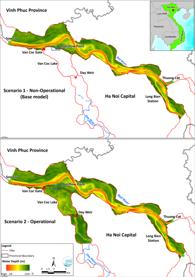

The water depth at peak flood time for the study area under both scenarios is presented in Figure 1. In Scenario 1, the base model, the hydraulic structures are not operated, meaning the Van Coc Gate, the overflow point, and the Day Weir remain closed. In Scenario 2, the Van Coc Gate, the Day Weir, and the overflow point are opened to allow the influx of floodwater.

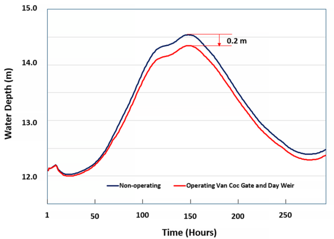

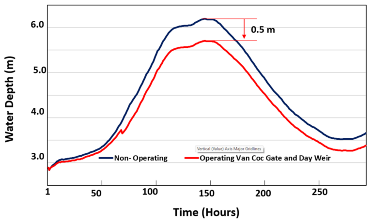

The water depths near Van Coc Gate and the Long Bien warning station are illustrated in Figures 2 and 3. The water levels decrease significantly from the operating to non-operating scenarios of the hydraulic structures. The decrease is up to 0.5 m in front of the Van Coc Gate and 0.2 m at the warning station
Throughout the simulation period, the river water depth follows a similar trend, with a peak of 14.5 m in Scenario 1 and 14.3 m in Scenario 2 at the Long Bien station. A reduction from 6.5 m to 5.7 m near Van Coc Gate was observed in Scenario 2. This reduction significantly alleviates pressure on Hanoi’s dike system and minimizes the flood impact on affected residential areas.
