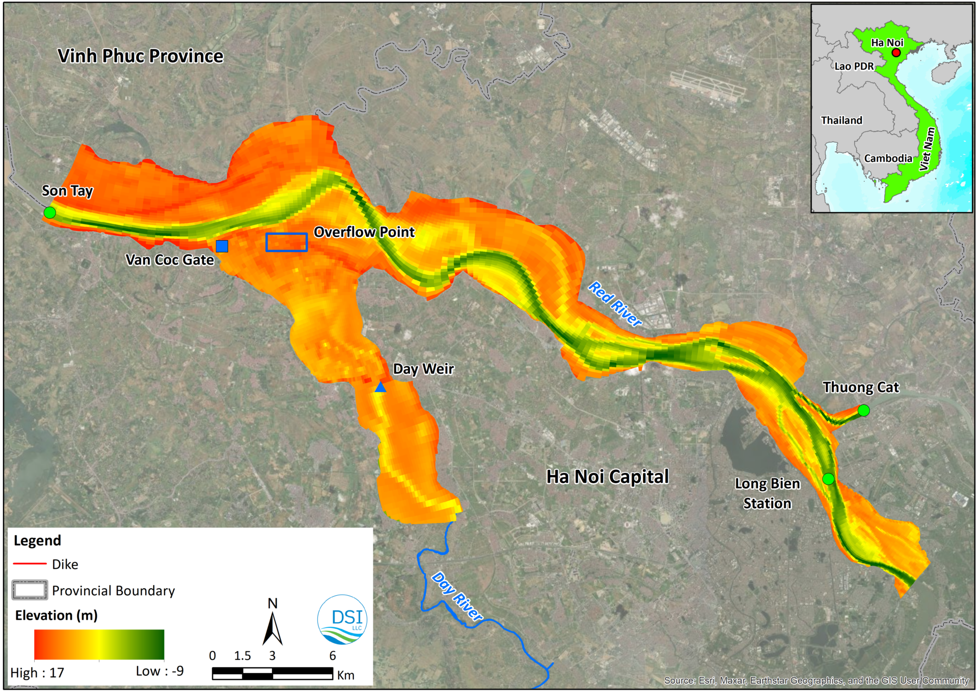

The location and elevation map of the research area are shown in Figures 1 and 2. The area includes part of the Red River region flowing through Hanoi, from Son Tay Station to the downstream of Long Bien Station, as well as the Van Coc Lake area. The riverbed elevation is varied, ranging from 9 m to 17 m.

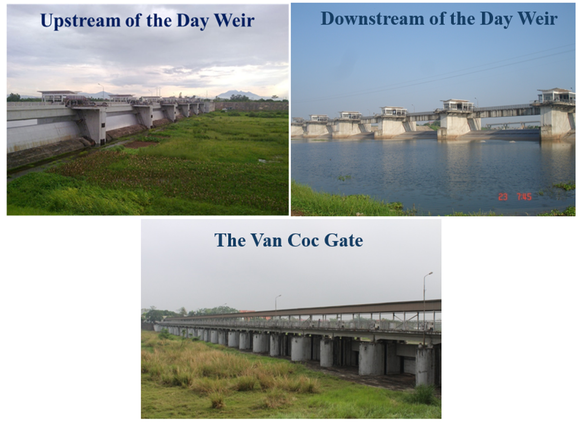

To protect Hanoi from flooding the Red River dike system was constructed centuries ago, and an emergency flood control solution has been in place since 1937. This solution involves discharging floodwater into Van Coc Lake, which serves as a regulating reservoir, through the Van Coc Gate and an overflow point located on the Red River bank. The water then drains into the Day River via the Day Weir. Photographs of the upstream and downstream of the Day Weir and Van Coc Gate are shown in Figure 3.

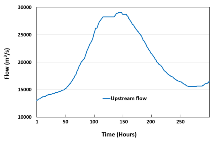

In both scenarios, observed discharge data from the 11-day period of the 1971 catastrophic flood were used as the upstream inflow boundary conditions at Son Tay Station.
