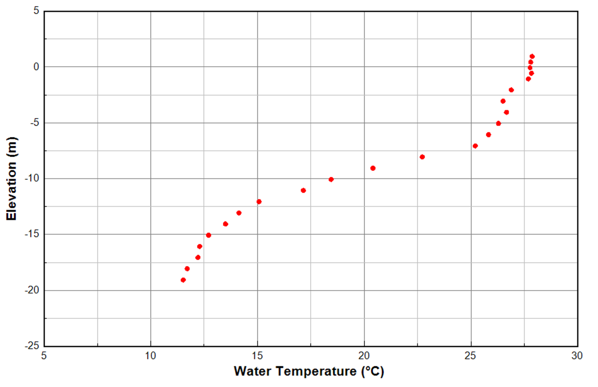

An example of a water temperature vertical profile is shown in Figure 1.
Figure 1. An example of water temperature vertical profile.

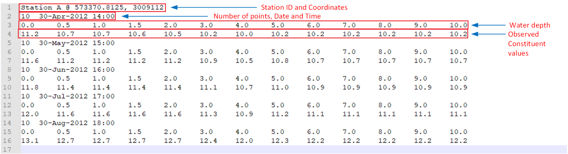

When there is data from multiple stations, it is advised to make a data file for each station. The file extension must be *.dat and its format should be as shown in Figure 2.
Figure 2. Data vertical profile file structure.
The first line contains the title (e.g., station name and location coordinate). This field is ignored when EE reads the file.
The second line contains the number of data points on the vertical profile (i.e., 10); Date (Gregorian) (i.e., 30-Apr-2012) and time (i.e., 14:00)
The third line contains the water depths from the surface at the point where the data is collected along with the vertical profile. The unit of depth must be in meters to be used in EEMS.
The fourth line contains observed constituent values corresponding to each depth in the third line. The unit must correspond to the model units.
Lines 2 to 4 are repeated for other profiles.

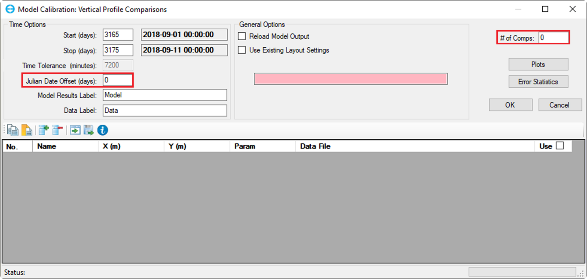

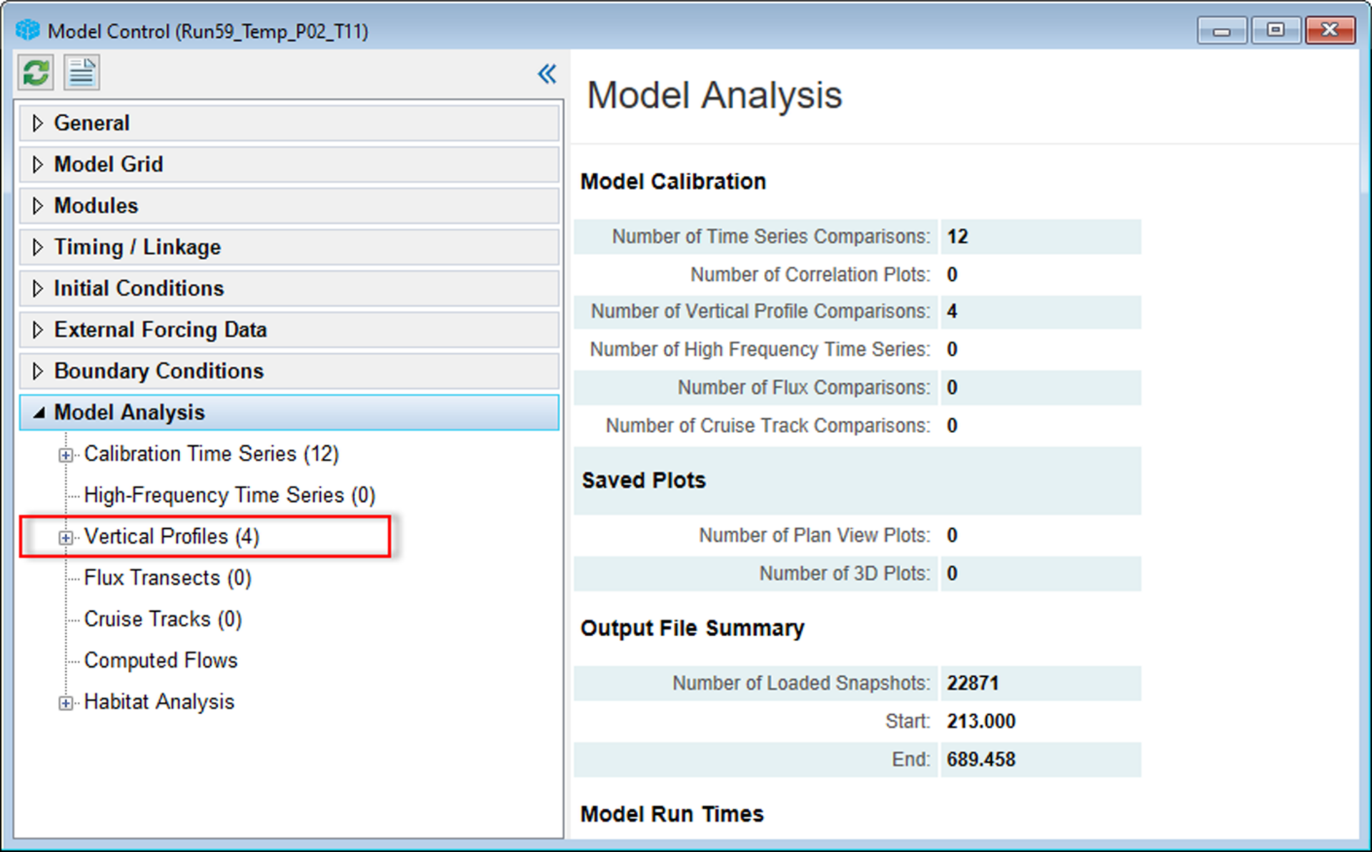

To compare model results with measured data, first select the Vertical Profiles under the Model Analysis as shown in Figure 3. RMC on the Vertical Profiles, then select Define Calibration Series. The Model Calibration: Vertical Profile Comparisons form will be displayed as shown in Figure 4.
Figure 3. Model Analysis – Main form.

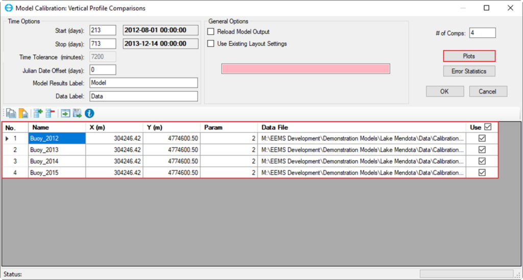

Figure 4. Vertical profile comparisons form.
The # of Comps is the number of data files we want to compare (number of calibration stations). This field will initially be “0” when starting the model-data linkage process. Enter the number of stations here, then press the Enter key. EE will create a line in the table for each station.

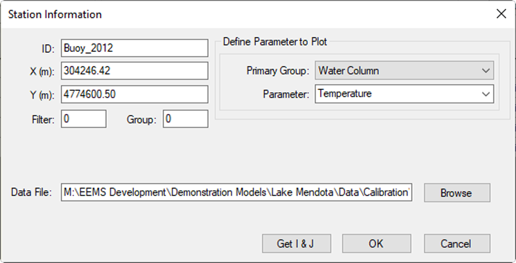

RMC on the cells in the table to open the Station Information form to define model parameters and data series file path. An example of the completed station information is shown in Figure 5. Fill in the station ID, coordinates, and parameter. Also, provide the path to the data file. Complete this form for each station before operating the model calibration feature (Figre 6 shows a completed list).
The Julian Date Offset is used when Julian dates have been used in the data files rather than Calendar dates. This offset allows the user to add the specified number of days to the Julian dates.
Figure 5. Defining station information.
Figure 6. Summary of stations configured to compare model results and data.

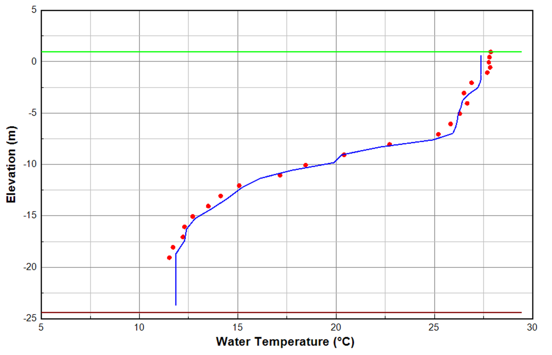

After completing the configuration, click the Plots button to show the vertical profile comparison. Figure 7 shows a comparison of observed and modeled water temperature vertical profiles.
Figure 7. Modeled vs. measured data vertical profiles.
