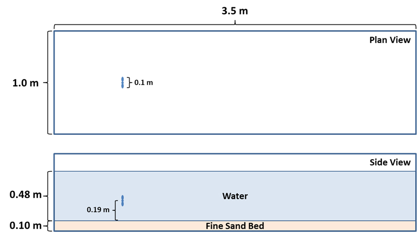

Figure 1 illustrates the dimensions of the synthetic flume used in this demonstration (L 3.5m x W 1m), along with the sediment bed and propeller setup used. The flume has a uniform bottom elevation, and the water depth is 0.48 m. The thickness of the sediment bed is 0.1 m, consisting of fine sand with a constant diameter of 100 µm (non-cohesive particles). The physical and erosional properties of the sediment bed are set to be uniform horizontally and vertically. The four-blade propeller has a diameter of 0.1 m, with a pitch ratio of 1.4, a blade area ratio of 0.4, and a thrust coefficient of 0.51. The propeller shaft was placed 0.19 m above the sediment bed surface. The total simulation period of this demonstration was 30 minutes. The propeller was operating with 1000 rpm for the first 20 minutes during the simulation, and the resuspended particles redeposited to the sediment bed during the 10 minutes remaining after the propeller stopped operating.
Figure 1. Synthetic flume used for the demonstration model.

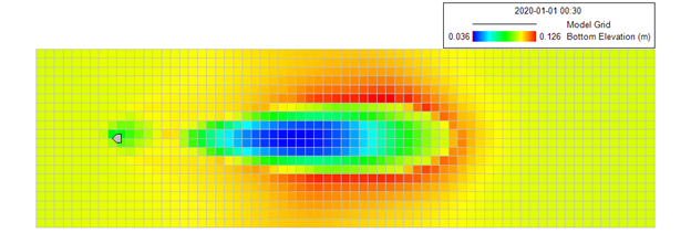

Following the 30-minute model simulation, a shallow hole formed right below the propeller, and the maximum scour occurred about 1 m away from the propeller (Figure 2). The dark colored grids show the areas with lower elevation (hole), and lighter colored grids show the area with higher elevation. The sediments eroded by the propeller from the scour hole deposited around it.
Figure 2. 2-Dimensional plan view of the bed elevation following the model simulation. Ship location is shown by the gray marker.

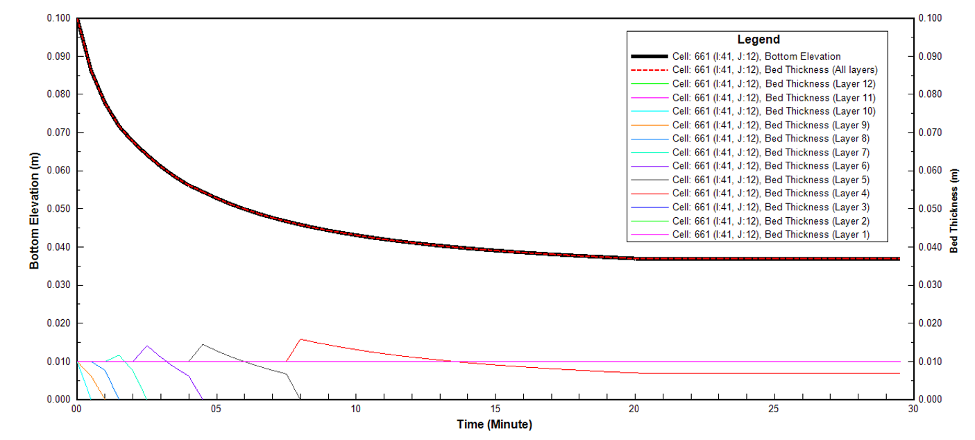

  • Bed Layer Thickness: Figure 3 presents the changes in bed elevation and sediment bed layer thickness during the simulation at the cell where the maximum scour occurred. The time series plot indicates that the bed elevation matches the total sediment bed thickness during the simulation. Additionally, we can also check how the sediment bed layers behave vertically while the sediment bed is being scoured due to the propeller action.

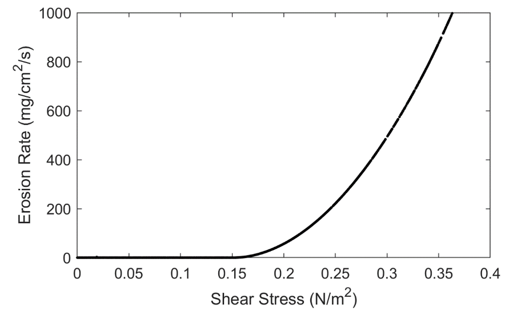

  • Erosion Rate: EFDC+ computes the propeller-induced velocity field, shear stress, and erosion rates based on an independent Lagrangian sub-grid mesh of each propeller. Figure 4 shows the relationship between the shear stress and erosion rate calculated at a specific time step (t = 5 min), based on the sub-grid points. We can confirm that sediment erosion initiates when the flow shear exceeds 0.154 N/m2, and then the erosion rate increases as the applied shear stress increases. This relationship is consistent with the behaviors suggested by van Rijn’s equations (1984a, 1984b, and 1984c) corresponding to sediment particles with 100 µm diameters.
Figure 3. Time series of bed elevation and sediment layer thickness at the maximum scour cell.
Figure 4. Shear stress and erosion rates computed for popeller wash sub-grid points.

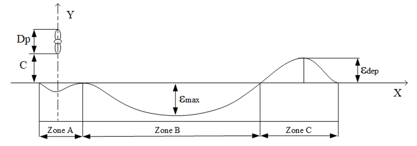

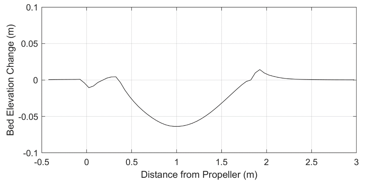

  • Scour Depth Profile: Figure 5 illustrates a general concept for a propeller-induced scour profile, which can be divided into a small scour hole below the propeller (zone A), a primary scour hole (zone B), and a deposition dune (zone C). Figure 6 demonstrates that the longitudinal profile of the simulated bed elevation changes align with the propeller axis, and this plot suggests that the model can reasonably reproduce the three indicated zones.
Figure 5. Schematic diagram of propeller-induced scour profile (modified from Cui et al., 2019).
Figure 6. Longitudinal profile of bed elevation changes after the 30-minute simulation.
