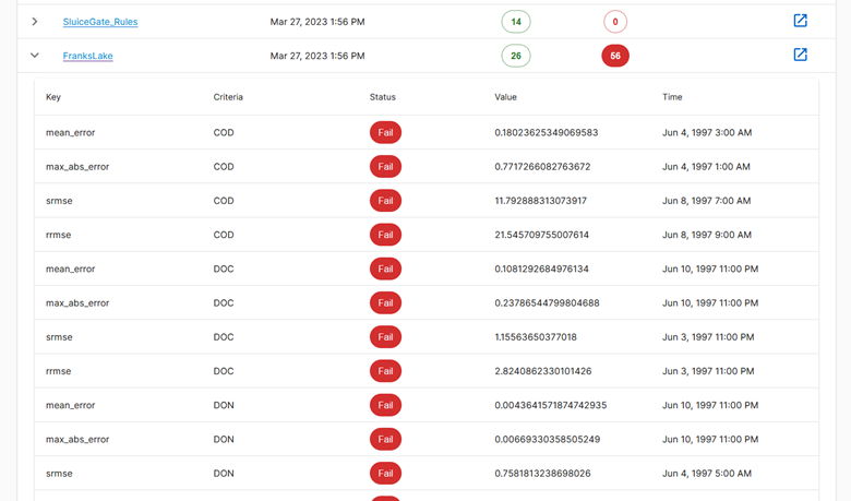

The very first evaluation is a very high-level overview that is provided by the testing journal. We can see if any tests were outside of the accepted threshold, as these will be reported as a “Fail”.
Max Absolute Error – The maximum absolute difference between the two model runs. This means that the models are compared cell by cell for each timestep. The largest absolute difference across the model domain is recorded for each timestep. When looking at the test results, if this value is zero, everything else will be zero (meaning the models are identical).
Mean Error – This is technically the difference in the mean values of the compared models as an absolute value.
Figure 1. EFDC+ Testing journal interface
Each test metric produces a value for each time step. A time series of these values is generated, but the test journal just displays the largest value for each metric at any point in time. The metrics reported for each parameter (e.g. – temperature, salinity) are the max absolute error, mean error, scaled root mean squared error, and relative root mean squared error.

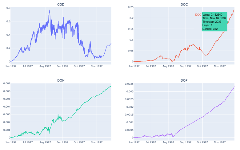

If a failed test is observed, we can use the auto-generated time series (output as HTML) to provide additional insight into the results. The example below shows an increasing max absolute error for DOC, DON, & DOP. We can hover over the data lines and see exactly where in the model domain these errors are occurring.
Figure 2. Time series plots of maximum absolute error for COD, DOC, DON, and DOP.
At this point, we might examine the commit to see if there is anything in the code we can easily attribute the changes to. Or we might open up EFDC+ Explorer to provide a more detailed look at the model behaviors. This would include looking the plan view of the model for various parameters such as water level, velocity, or temperature, at different times to determine instability or unexpected behaviour in the model. In addition, we often plot time series of other related parameters, as well as vertical profiles, slice views, and model comparison plots.
