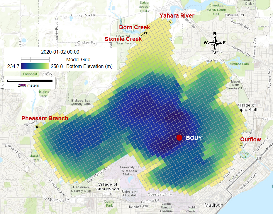

Figure 1: Lake Mendota Model Configuration
Figure 1 illustrates the model grid, locations of the boundary conditions, and the bottom elevation. The model domain is discretized using a uniform grid of 1405 cells, each with a resolution of 170 m × 170 m. The vertical layering uses SGZ uniform layers option varying from 3 to 30 layers. The model simulates two algal groups: cyanobacteria and diatoms. Nutrient constituents include organic carbon, nitrogen, phosphorus, and silica, each represented by their respective sub-classes: refractory particulate, labile particulate, and dissolved fractions. The total number of water quality constituents simulated is 18. The simulation period covers one year, from January 7, 2012, to December 28, 2012. Two model runs were conducted using the original upwind scheme implemented in EFDC+ and the new ULTIMATE-QUICKEST option, respectively:

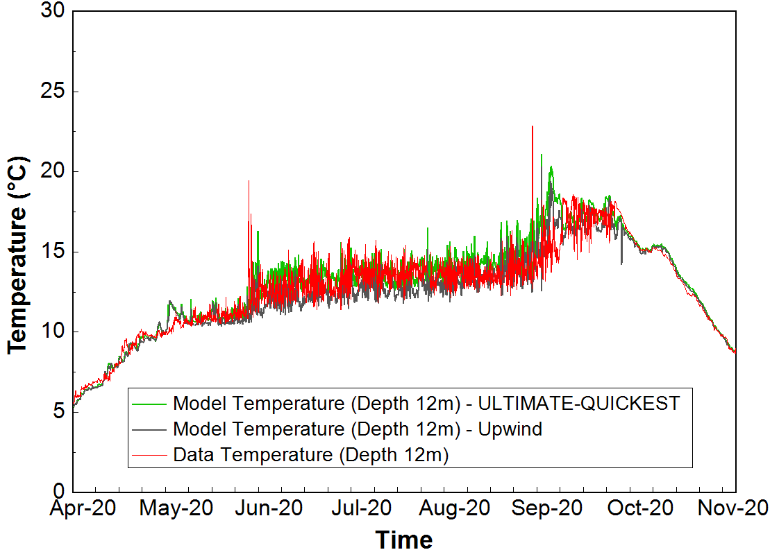

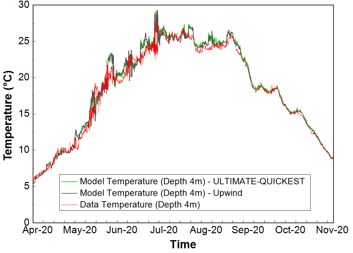

Figures 2a and 2b compare the time series of temperature at different water depths at the BUOY point obtained from the two model runs. Minor differences between the Upwind and ULTIMATE-QUICKEST schemes are observed; however, overall, both schemes show good agreement with the observed data.
Figure 2a: Comparison of temperature time series at BUOY location at 4m depth
Figure 2b: Comparison of temperature time series at BUOY location at 12m depth

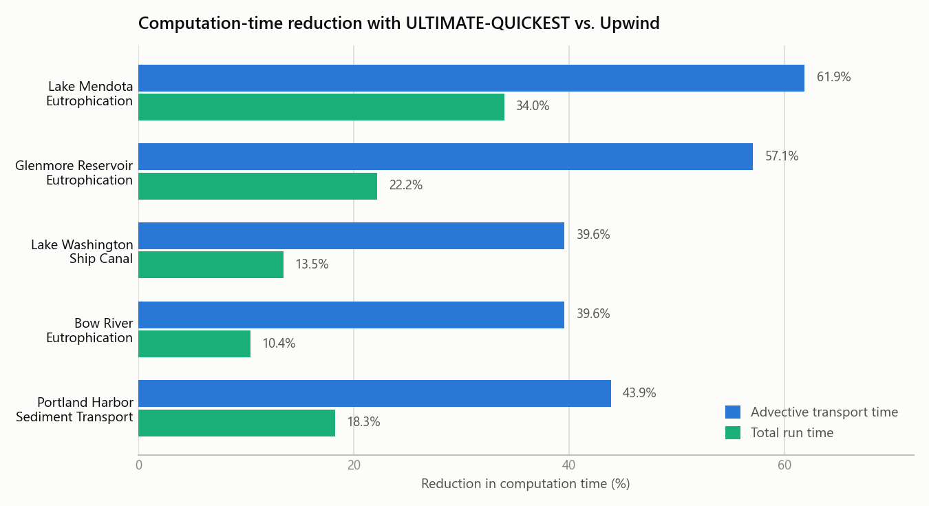

Regarding computational efficiency, Figure 3 summarizes the reduction in computation time achieved by ULTIMATE-QUICKEST relative to the Upwind scheme across five real-world model applications, for both advective transport time and total model run time. The ULTIMATE-QUICKEST method significantly reduces the time spent on advective transport — by roughly 40–62% depending on the model — which in turn lowers the total model run time by up to approximately 34%. The efficiency gains become more pronounced as the number of simulated constituents increases. Additionally, 3D models exhibit greater reductions in computation time compared to 2D models, as they include advective transport in the vertical direction.
Figure 3: Reduction in computation time achieved by ULTIMATE-QUICKEST relative to the Upwind scheme, for advective transport time and total model run time across the five test applications.
