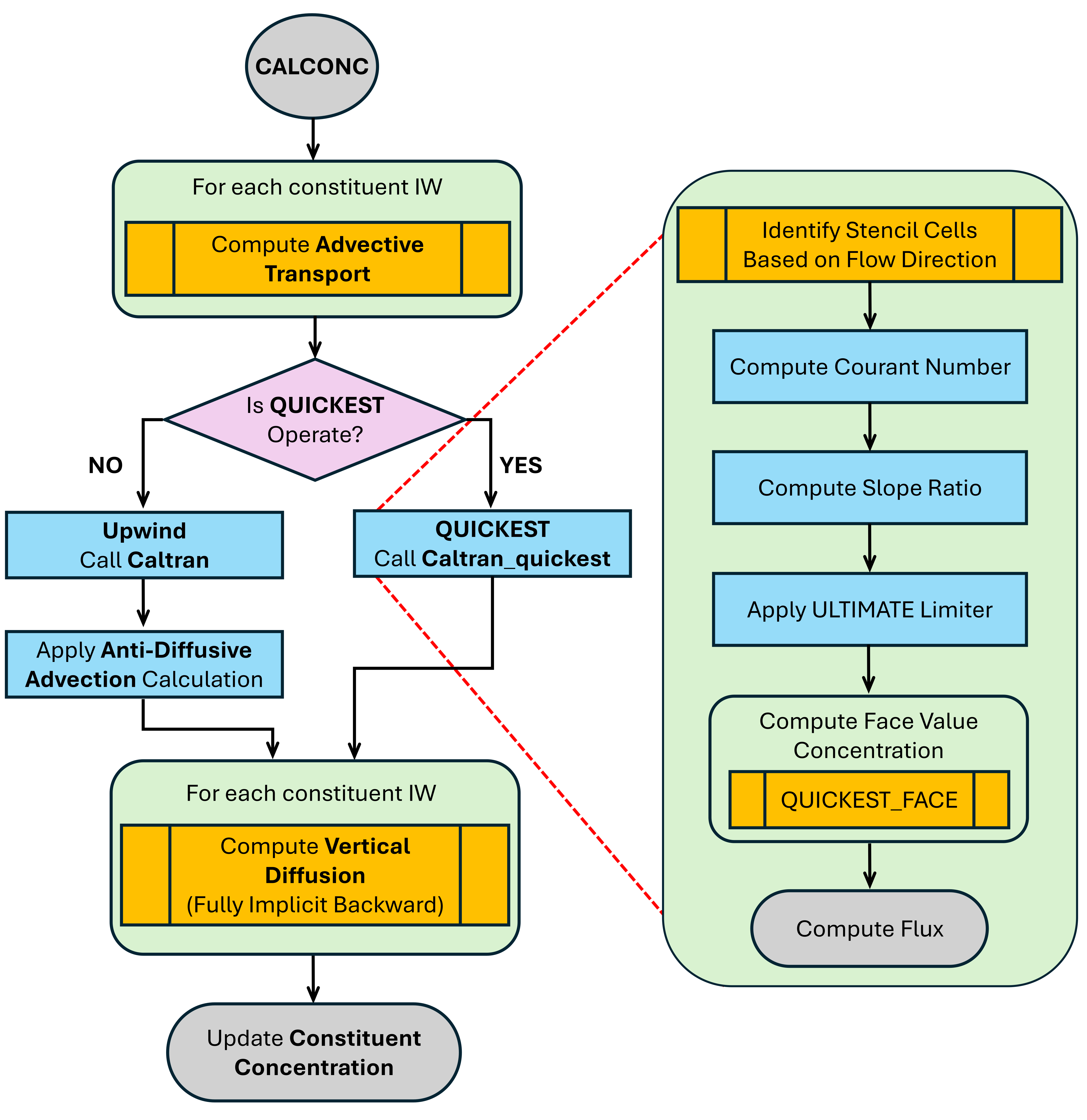

Figure 1. Implementation scheme of the ULTIMATE-QUICKEST algorithm.
Figure 1 presents a flowchart illustrating the implementation of the ULTIMATE-QUICKEST scheme in EFDC+, alongside the original upwind scheme. For the upwind solution in EFDC+, constituent transport is solved in subroutine CALCONC, with advective transport handled by subroutine CALTRAN. To incorporate the ULTIMATE-QUICKEST algorithm, a new subroutine, CALTRAN_QUICKEST, was developed to complement the existing CALTRAN routine. This subroutine uses the QUICKEST scheme for advective transport alongside a new function QUICKEST_FACE, which computes face concentrations using the third-order formulation with the ULTIMATE limiter to ensure monotonicity. Unlike the upwind, which typically requires anti-diffusion corrections to improve accuracy, the QUICKEST approach achieves higher accuracy inherently while maintaining numerical stability.

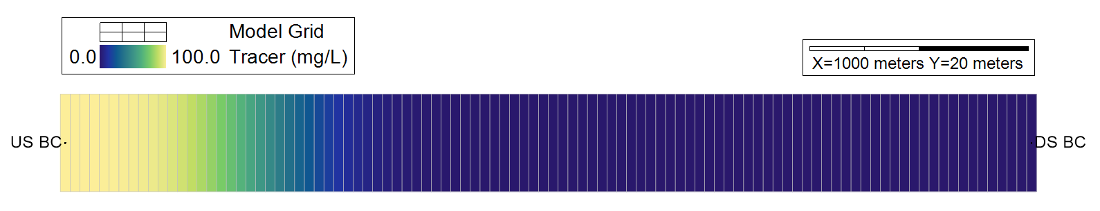

The Chapra Anti-Diffusion benchmark is used to evaluate ULTIMATE-QUICKEST against the existing upwind scheme. The test case is a 1D rectangular channel 5000 m × 10 m with a conservative tracer 100 mg/L introduced via an upstream inflow of 2 m³/s, discretized into 100 uniform cells 50 m × 10 m (Figure 2). Diffusion coefficient is set to 5 m²/s. Three model runs were conducted using three different numerical options for advective transport in EFDC+, as follows:
  • Run01 – Upwind Difference
  • Run02 – Upwind Difference and Anti-Diffusion Correction
  • Run03 – ULTIMATE-QUICKEST
Figure 2. Chapra-Diffusion: model configuration.

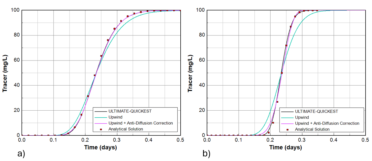

Figure 3a compares tracer concentration at 2000 m downstream for all runs against the analytical solution. ULTIMATE–QUICKEST (Run03) and Upwind with Anti-Diffusion Correction (Run02) both closely match the analytical solution, while Upwind alone (Run01) shows notable deviations due to numerical diffusion. In EFDC+, this issue can be mitigated by enabling the Anti-Diffusion Correction option; however, this improvement comes at the cost of increased computational time.
Figure 3. Comparison of tracer time evolution for a) P_\Delta = 1 and b) P_\Delta = 5.
Figure 3. Comparison of tracer time evolution for a) PΔ=1P_\Delta = 1 and b) PΔ=5P_\Delta = 5.
The influence of Péclet number PΔP_Δ, which represents the relative importance of advection and diffusion, was also examined. The previous model runs use a diffusion coefficient of 5 m²/s resulting in PΔP_Δ = 1. Three additional model runs were conducted with the diffusion coefficient reduced to 1 m²/s, yielding a Péclet number PΔP_Δ = 5, indicating that advective transport becomes the dominant. Under these conditions (Figure 3b), the results indicate that the Upwind scheme with Anti-Diffusion Correction no longer matches the analytical solution, while QUICKEST maintains good agreement.
