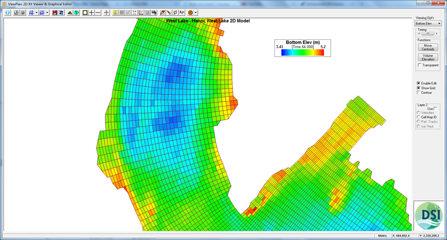

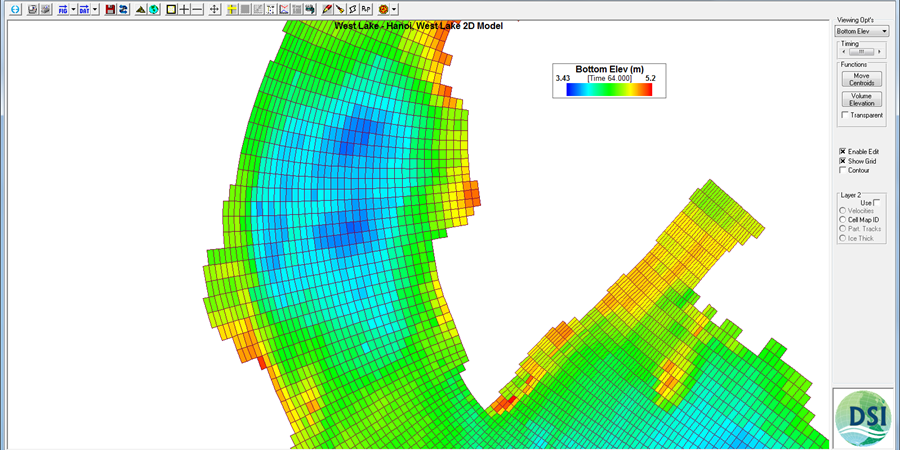

Did you know that EFDC_Explorer has the ability to triangularize its cells?
To make the change, click anywhere in the image view to set the focus. Make sure the “Enable Edit” option is checked. Then press Alt+T to apply the triangularization.
