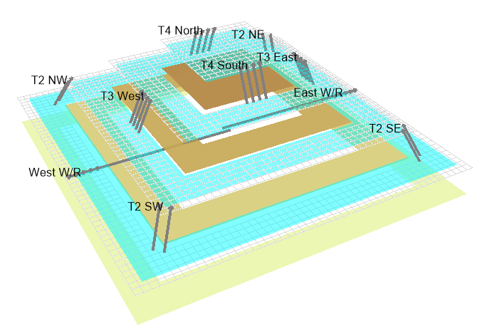

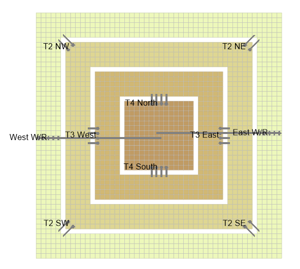

The model geometry of the pyramid consists of a square cascade fountain with four steps and a central axis of symmetry. The cascade fountain step widths are 140 m, 260 m, 380 m, and from top to bottom. The height of each step is uniform, with a value of 3 m. Water flows out from the top step of the pyramids and cascades down the steps below. At the bottom, the water collects in a basin, where a pump circulates the water back to the top of the fountain. For the numerical model configuration, a grid of 2,176 uniform cells, and cell size of 10 x 10 m, is used to represent the cascade fountain. Several model hydraulic structures,including pipes connecting the four tiers (T) and withdrawal/return structures (W/R),are set up to simulate the circulation of the flow as shown in Figure 1 and Figure 2.
The EFDC+ LPT module is used to simulate the motion of 4,000 particles in the cascade fountain, seeded at random depths at the center of the top step. The particles are considered neutrally buoyant, so their motion is solely governed by the water’s velocity field. It is noted that the option of “neutrally buoyant particles” is a vital tool in LPT, representing particles that move with the fluid flow without sinking or rising. Random walk is also incorporated into the horizontal movement to represent the diffusion and dispersion of particles due to the turbulent effects.
