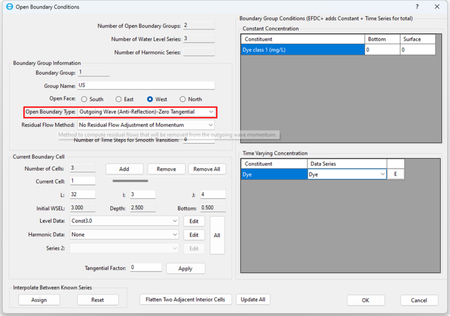

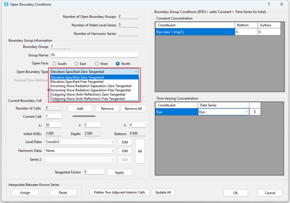

In the Open Boundary Conditions form, click the Open Boundary Type to reveal a drop-down menu. This menu offers six options, as illustrated in Figure 1. Detailed descriptions of each boundary type are provided in this blog.
Zero Tangential and Free Tangential
The six available options can first be separated into two categories: Zero Tangential and Free Tangential.

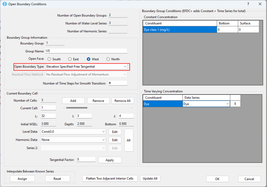

  • Free Tangential: This option allows tangential flow at the model boundary. Meaning it allows lateral flow or exchange of momentum parallel to the model boundary.

Elevation Specified is the standard method for open boundary. It is most suitable for estuaries and coastal areas affected by tides. It is not optimal if the water elevation time series has sudden changes or the model area is relatively small. When the water elevation time series has sudden changes or the model area is relatively small, the excess momentum from the introduced pressure gradient will usually cause a “seiching” effect within the model domain, which requires a longer time for the model to subside.
If the user notices their model suffers from this issue, they may consider switching to other options below. It is recommended that the user match the initial water elevation with the boundary time series, no matter which option is selected.

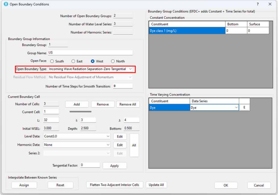

Incoming wave radiation separation is a legacy option in EFDC+. With the Radiation Separation boundary condition, the incoming wave at an open boundary is separated from the outgoing wave, assuming the incident wave is twice the required surface elevation (Zhou, 2014). This option effectively reduces waves generated in the interior of the model domain, diminishes the affect of wave reflection, and allows the model to reach the desired water movement faster than the “Elevation Specified” option. However, due to the nature of this method, when assigning a tidal-like water elevation time series as a boundary condition, the result of this option may have two times the fluctuation in water level and velocities. Therefore, this option is more suitable for an open boundary with fixed value elevation (does not change in time like tide) or a simple test case model.

The outgoing wave option also allows waves generated in the interior of the model domain to pass outward across the boundary with no reflection. This makes the model reach a steady state faster compared with the “Elevation Specified” option. If the users find the result of the model using the “Elevation Specified” option shows a “seiching” behavior (back and forth velocity), the outgoing wave option will be a good substitution.
Unlike the “Radiation Separation” option, the outgoing wave option will not increase the water elevation and velocity magnitude results by two times. Another good use case for this option will be test case modeling. Usually, the test case model has a much simpler environment (i.e, wave flume), and the modeling time period is often shorter than general environmental modeling cases. Therefore, having water movement reach a desired condition within a short time is critical. The “Outgoing Wave” option would be an optimal choice for open boundary conditions.
