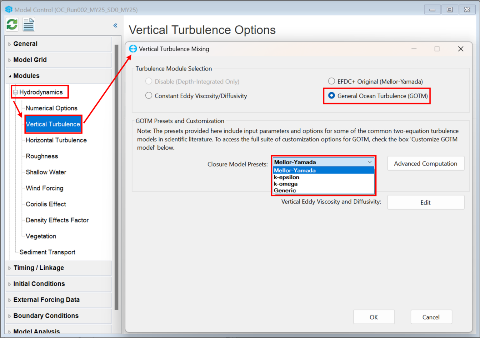

EFDC 12 was employed to simulate the effects of different turbulence models on sediment transport. Starting from EEMS version 12, users have the flexibility to construct models using turbulence closures sourced from GOTM (General Ocean Turbulence Model) for vertical turbulence, in addition to the original EFDC+ options.This flexibility enables users to choose turbulence closure models (k-ε, k-ω, MY25) within a consistent numerical framework.
This blog investigates the performance of three turbulence closure models - k-ε, k-ω, and MY2.5 - using a three-dimensional numerical simulation. The focus is on how these turbulence models affect critical aspects of sediment transport, such as bed shear stress, and total suspended solids (TSS). We analyze the implications of these models in an open channel test case, where flow is steady, homogeneous, and influenced by resuspension and diffusion of sediment. The turbulence settings of the three models are as shown in Figure 1.
Figure 1. GOTM Turbulence settings

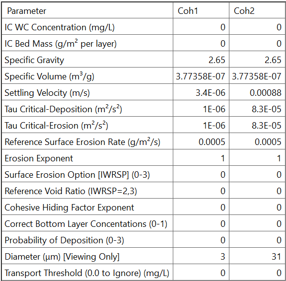

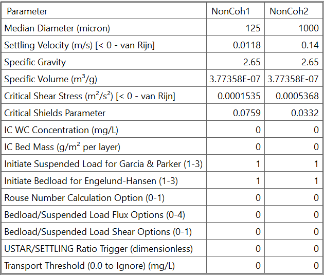

The sediment model has three sediment layers with four sediment classes including two cohesive and two non-cohesive classes. The erosion and deposition parameters used for cohesive and non-cohesive sediments are shown in Tables 1 and 2.
Table 1. Non-Cohesive sediment parametrization
Table 2. Cohesive sediment parametrization

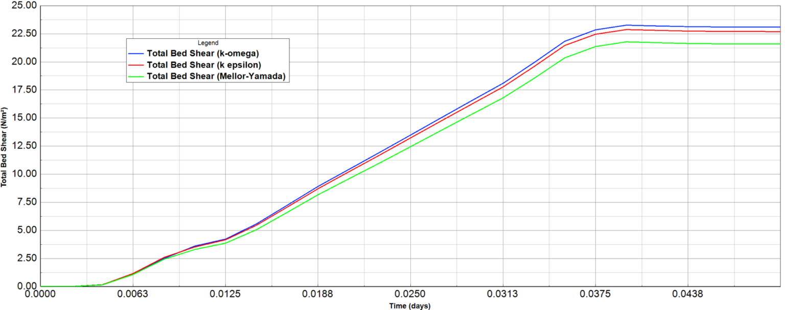

Bed Shear Stress
The bed shear stress is a crucial factor for sediment resuspension. Among the models, the k-ω scheme showed the highest shear stress. The MY2.5 model exhibited lower shear stresses, while the k-ε model was intermediate (Figure 2). The differences in bed shear stress directly influence the resuspension rates of sediment, with k-ε promoting the most vigorous resuspension.
Figure 2. Bed shear stress for different turbulence models at a cell in the middle of the channel.

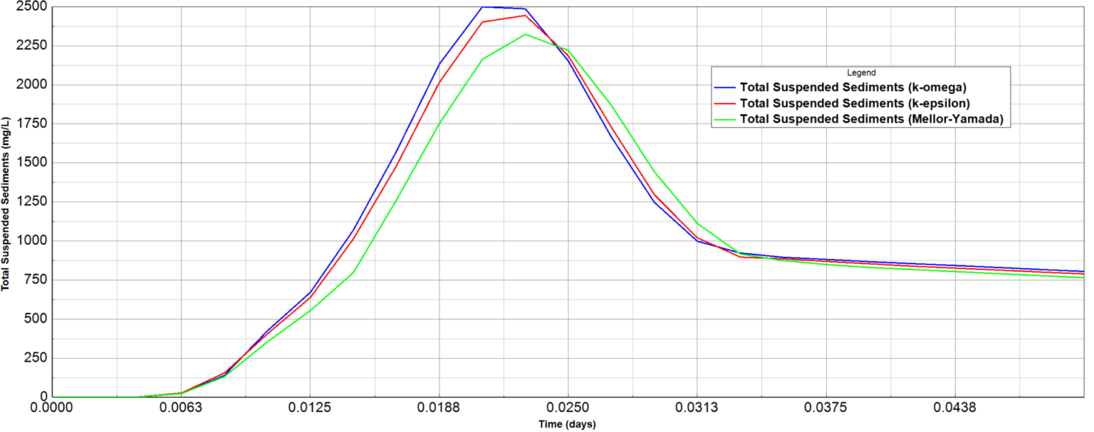

Total Suspended Solids (TSS)

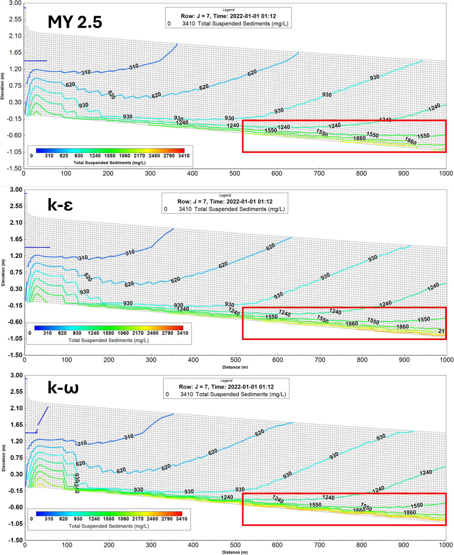

The distribution of TSS was found to be sensitive to the choice of turbulence model, as it is strongly tied to the vertical mixing and resuspension dynamics. The k-ω model resulted in the highest concentrations of suspended sediments (Figure 3), due to its higher bed shear stress (Figure 2) and more efficient vertical mixing. In contrast, the MY2.5 model produced lower concentrations of TSS, with less effective mixing of sediments throughout the water column. The k-ω model yielded results between these extremes. Figure 4 shows the Modeled suspended-sediment concentrations along a transect, as shown the difference between the 3 GOTM turbulence cases is not very big but k-ω has the biggest TSS.
Figure 3. Depth average total suspended solids for different turbulence models at a cell in the middle of the channel.
Figure 4. Modeled suspended-sediment concentrations contours with three GOTM closure methods
