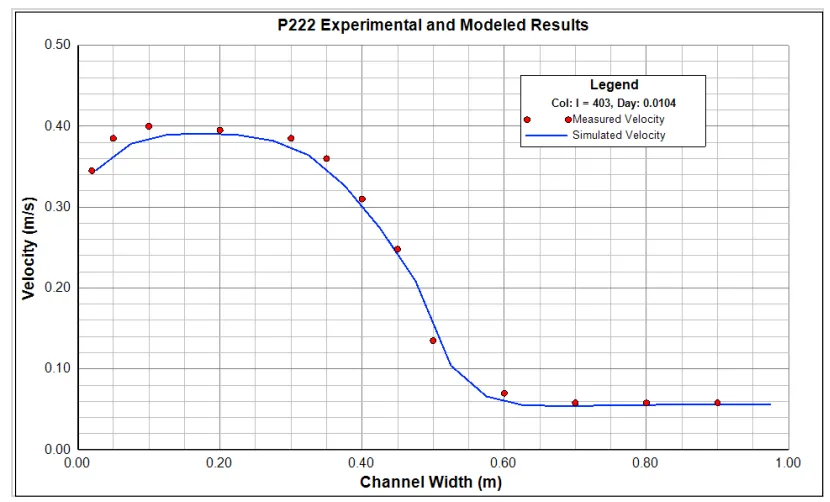

Description:
This model replicates the test cases presented by Pasche and Rouvé, who examined vegetation–flow interactions in laboratory flumes described in the journal article by Fischer-Antze et al., “3D Numerical Modelling of Open-Channel Flow with Submerged Vegetation”. The objective is to use EFDC+ Explorer (EE) and EFDC+ to simulate these vegetation–flow interactions and to validate model performance against measured velocity data from three experimental configurations. Through this comparison, the study aims to assess how effectively EFDC+ represents the influence of rigid submerged vegetation on open-channel flow dynamics.
