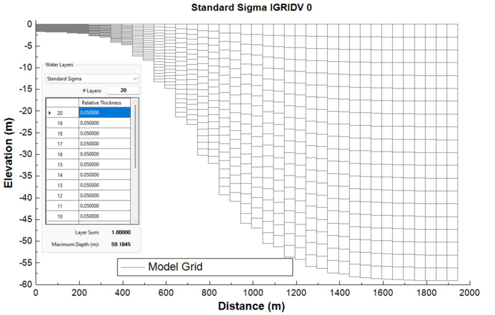

Standard Sigma Coordinate (GRIDV=0)
The Standard Sigma (SIG) approach is a topographically conformal vertical coordinate system that is widely used in three-dimensional hydrodynamic models. In the SIG coordinate formulation, the number of vertical layers is the same at all horizontal locations in the model grid, regardless of the water depths. An illustration of the approach can be seen in Figure 1. The SIG approach has been successfully applied for estuary modeling (e.g., Galperin et Mellor 1990) and to correctly simulate the bottom boundary layer to represent tidal mixing. However, it is subject to horizontal pressure gradient errors when the system has steeply sloping beds relative to the horizontal grid size (Mellor et al., 1994). This occurs because the standard sigma coordinate system aligns its vertical layers with the varying bathymetry, causing uneven spacing of grid points along the sloping terrain. Consequently, the calculation of horizontal pressure gradients becomes distorted as the vertical layers fail to accurately represent the true depth variations, particularly in regions of pronounced topographic relief.

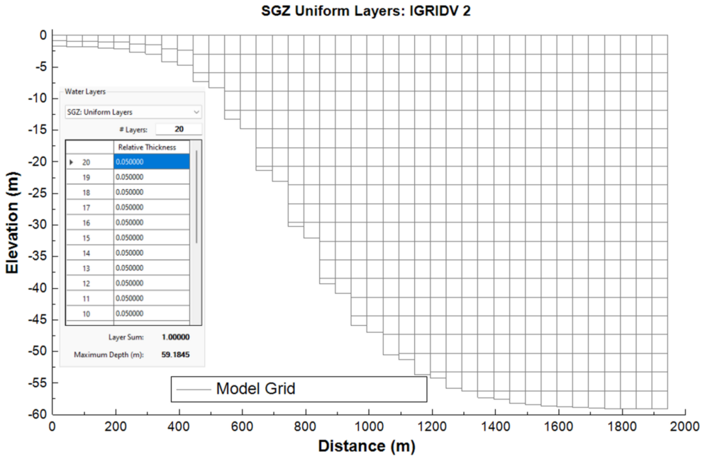

Sigma-Zed Uniform Layer (GRIDV=2)
Similar to the SGZ-Specified Bottom Layer option, in this SGZ approach, a configuration file (sgzlayer.inp) for the vertical layering scheme is generated by EE based on the cell water depth. The layering is built from the top, keeping the bottom of each layer aligned in the horizontal direction, as shown in Figure 3. This means that despite variations in bathymetry (like sloping riverbeds or varying estuary depths), the boundaries between the layers remain parallel and uniform, providing a consistent structure for modeling. The SGZ-Uniform Layer is most suited to lakes and waterbodies where the water levels are generally uniform over the model domain. For example, this option has been used in Lake Mead and Lake Washington, where the water surface elevation rises and falls uniformly.

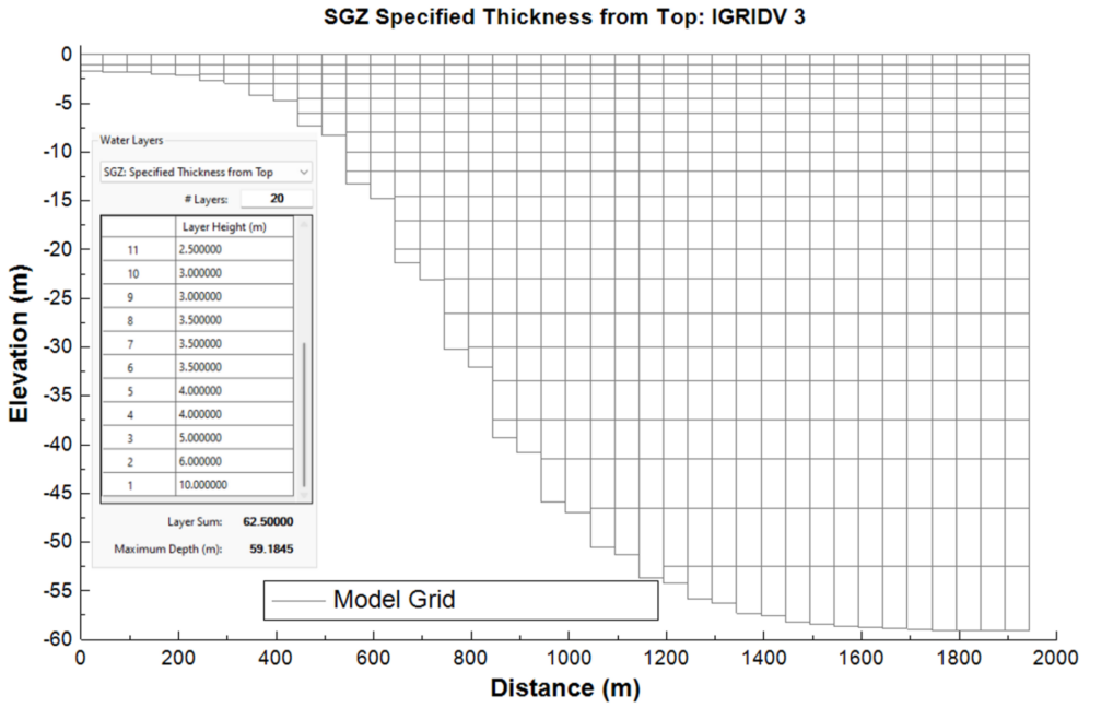

Sigma-Zed Specified Thickness from Top (GRIDV=3)
The SGZ Specified Thickness from Top is a new option for vertical layering in EEMS 12.1. When using this approach, the user can configure the model layers not as relative splits but as actual layer thicknesses in meters. The layers are built starting from the top, and the bottom of each layer is aligned in the horizontal direction. This option gives the user the flexibility to specify the layer thickness and the maximum depth of the model domain to generate an appropriate vertical layering scheme. It appears similar to a Z coordinate grid in the initial condition. However, the layer thickness will vary according to the evolution of the water depth during the simulation.
In practice, ensuring the layer sum and the max depth match is unnecessary, as EE will truncate any if they do not match. For example, if the model has a max depth of 40 m, but the layers to sum 60 m, then the redundant bottom 20 m will be truncated. Conversely, if the max depth is 60 m and the layer sum is 40 m, then the bottom 20 m will be lumped into the bottom layer. An example of the layering scheme generated by this option is shown in Figure 4.
