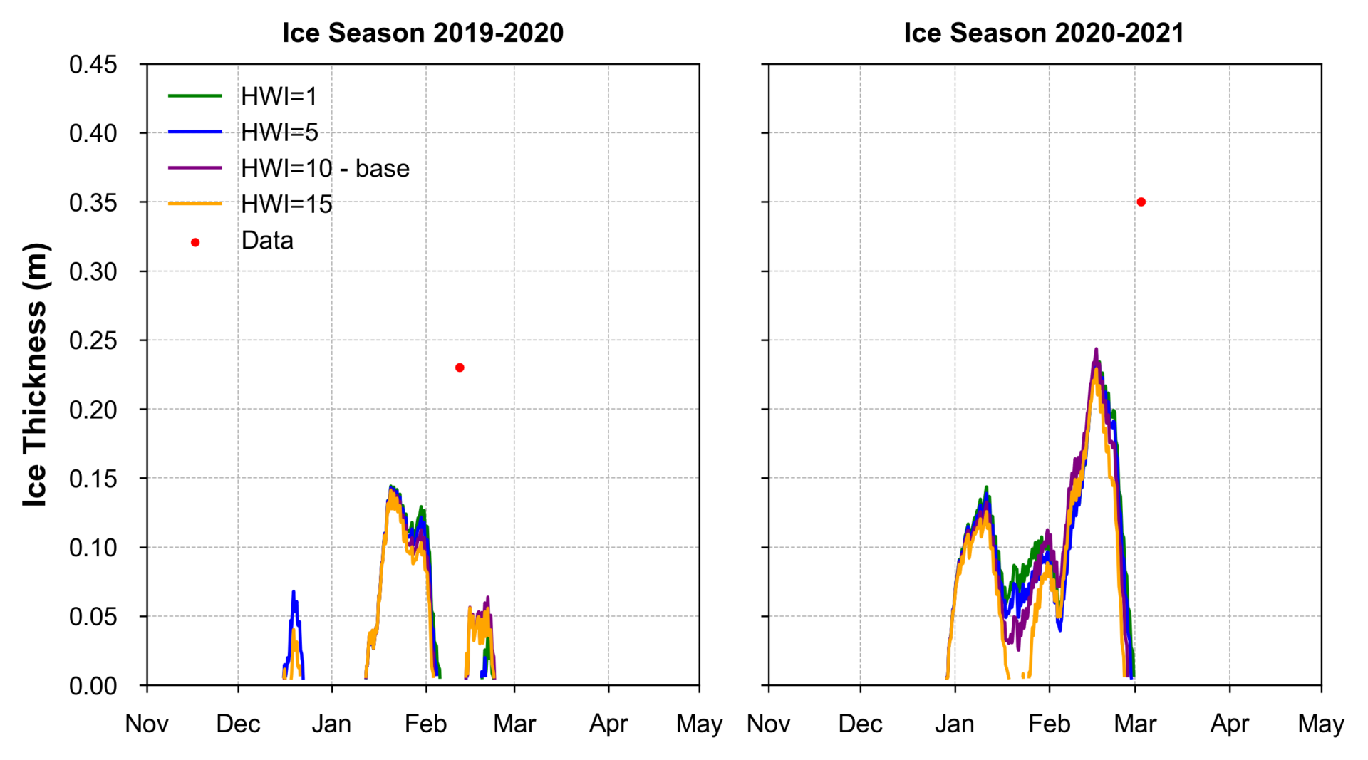

Coefficient of Water-Ice Heat Exchange (HWI)
A comparison of ice thickness at the buoy over two seasons (2019-2020 and 2020-2021) with different HWI values (1, 5, 10, and 15) is shown in Figure 2. The red dot represents observed data points. It can be seen that the sensitivity of HWI varies with months. Higher HWI values lead to greater ice thickness as the simulation progresses towards March, with HWI=15 (orange) showing the most significant effect, while lower HWI values correspond with thicker ice during January.

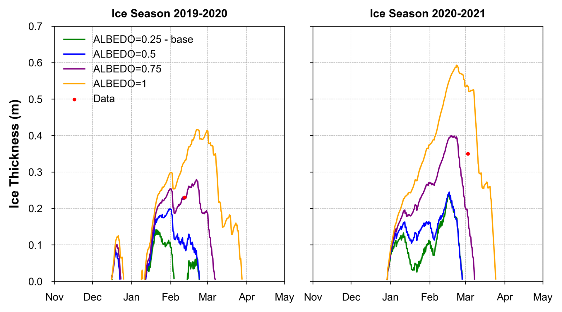

Reflection Fraction of Solar Radiation (ALBEDO)
The model results obtained with different albedo values (0.25, 0.5, 0.75, and 1) alongside actual data points are given in Figure 3. Albedo, which measures the reflectivity of the ice surface, significantly impacts ice thickness. For both seasons, higher albedo values generally correspond to greater ice thickness and more extended periods of ice cover, as more sunlight is reflected, reducing melting. The actual data points, however, show some divergence from the modeled predictions, particularly in the 2020-2021 season, indicating that while albedo is a crucial factor, other variables might also play significant roles in determining ice thickness.

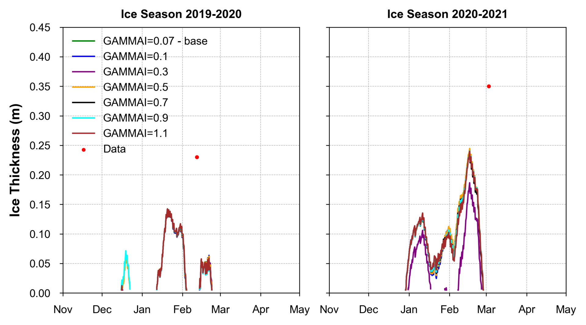

Ice Light Extinction Coefficient (GAMMAI)
Ice thickness over two seasons (2019-2020 and 2020-2021) with various GAMMAI values ranging from 0.07 to 1.1 is shown in Figure 4. Across both seasons, the differences in ice thickness between GAMMAI values are relatively small, with the black line (GAMMAI=0.7 and GAMMAI=1.1) showing slightly thicker ice than the lower GAMMAI values (e.g., 0.07, 0.1). This indicates that GAMMAI has a more modest influence on ice thickness than the previously tested parameters.

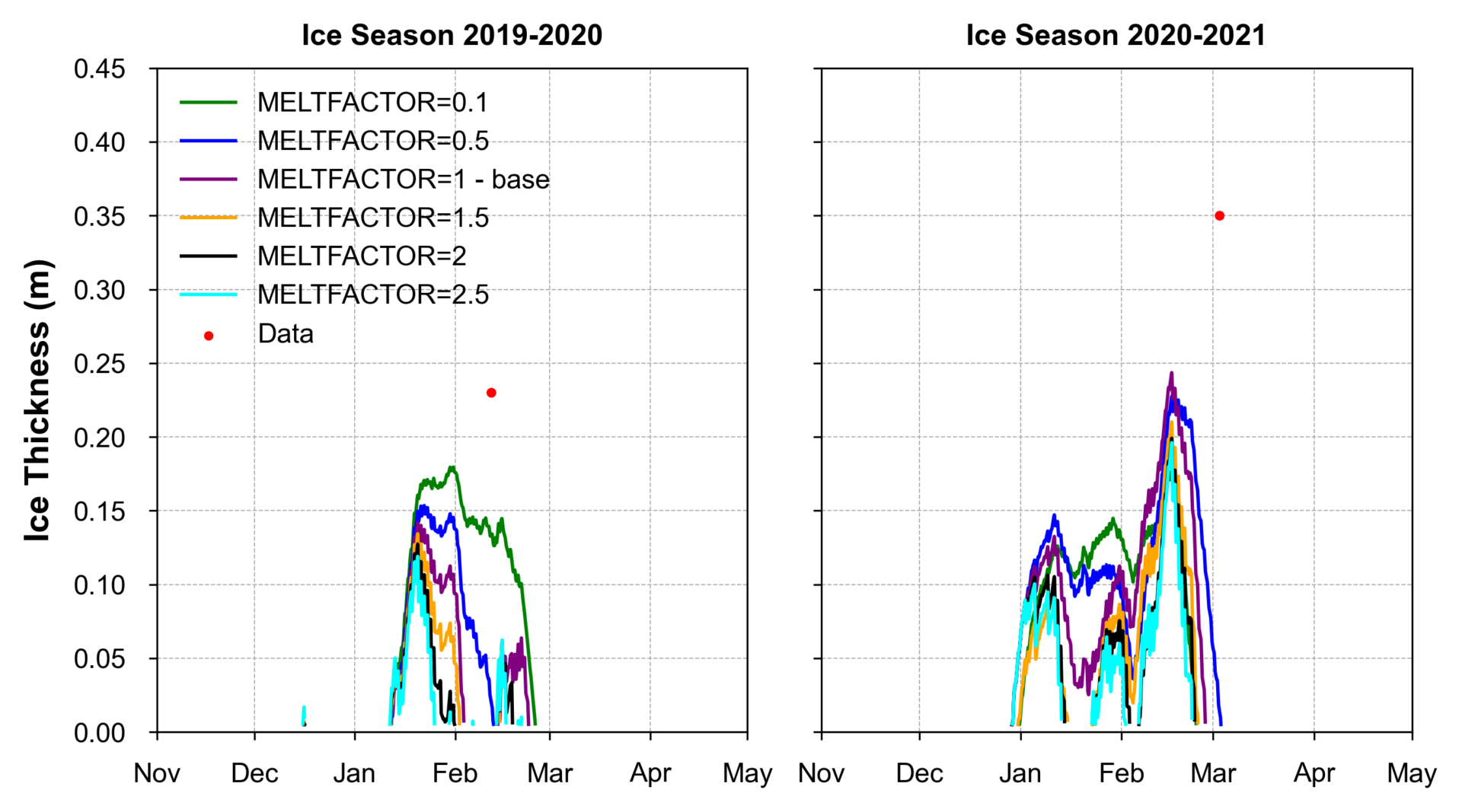

Ice Melt Factor (MELTFACTOR)
The ice thickness over two seasons (2019-2020 and 2020-2021) under different melt factor scenarios (MELTFACTOR between 0.1 and 2.5) with actual data are shown in Figure 5. For both seasons, MELTFACTOR=0.1 aligns best with observed data. A greater negative melt factor means significantly longer episodes of ice cover and a thicker freezing layer.
