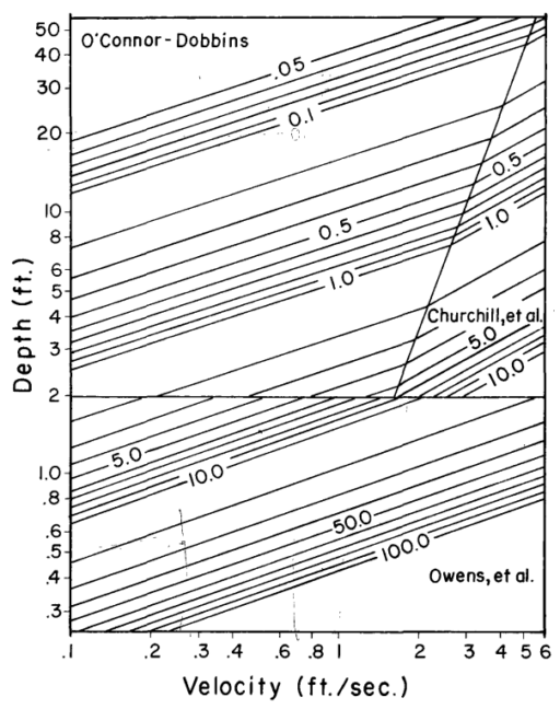

For a flowing system, the transfer coefficients are controlled by flow-induced turbulence. The film liquid phase transfer coefficient (KL, m/s) is then computed using the Covar method (Figure 1), in which the equation used varies with the velocity and depth of the cell. For cells with a depth less than 0.61 m (2 feet), the Owens formula (Eq. 1) is used to calculate. For segments with cell depth greater than 0.61 m and 4.08 the O’Connor-Dobbins formula (Eq. 2-1) is used. In all other cases, the Churchill formula (Eq. 3) is used to calculate the volatilization rate.

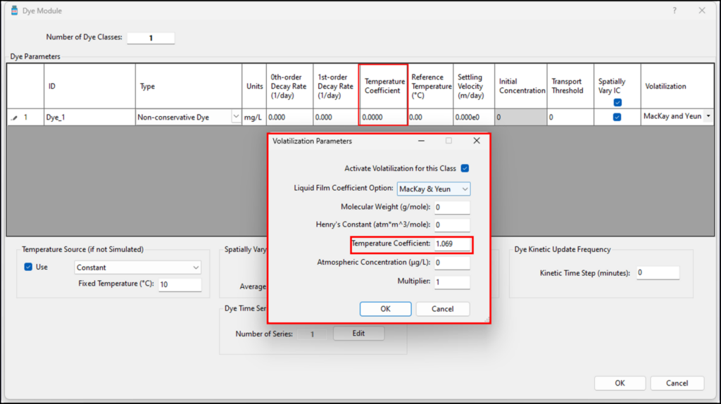

For more quiescent conditions, such as lakes or ponds, the transfer coefficients are controlled by wind-induced turbulence. For these systems, the liquid film transfer coefficient (KL) is computed using either the O’Connor equations or Mackay & Yeun (1983). The user interface for configuring these options is shown in Figure 2.
Once the liquid file transfer coefficient (KL) is computed, the volatilization transfer rate (conductivity, Kv) is calculated based on the two-layer resistance model by Whitman et al. to incorporate the gas phase resistance. The final conductivity is then adjusted for water temperature.
Although many calculations are involved in determining volatilization, most are performed internally using a small data set. Volatilization data specifications are summarized in Table 1 below. Not all of the constants are required. Volatilization is only active for the surface layer. It can be observed from Figure 1 that there are two temperature coefficients. The main form uses the temperature coefficient for the decay options. Only the temperature coefficient in the Volatilization Parameters form is used for volatilization.
