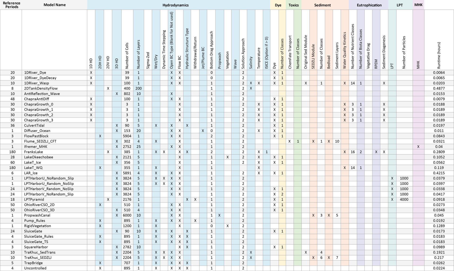

We currently have around sixty different models grouped into three separate tiers. Tier 1 models are designed to run quickly. At a minimum, these models run whenever a commit is pushed to any of our permanent branches. Tier 2 models are generally more complex, real-world models that may take a few hours to run. These are run on a monthly schedule and often several times in the lead-up to a release, using the latest builds of EFDC+. Tier 3 contains a collection of models that generally require several days of runtime. These are not a part of the test automation and will be excluded from this review.
The goal of these models is to provide solid test coverage for the major features of EFDC+. As stated previously, they need to run quickly and demonstrate the targeted model behavior in the limited run period. Tier 1 is arguably the most important group, as these models will likely quickly uncover any major issues with a code update. The vast majority of these models are available for download from our website as test case or demonstration models. All such models can be run using EEMS in the free demo mode. Below is a table of the complete model list for Tier 1 models, which shows at a glance the various modules being tested and relevant settings. Table 1 is helpful for identifying which modules or features are being tested and detecting gaps in the testing process.
Table 1. List of Tier 1 Models

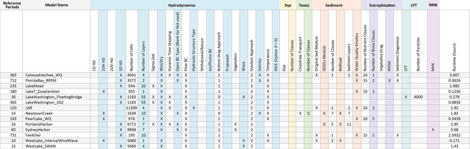

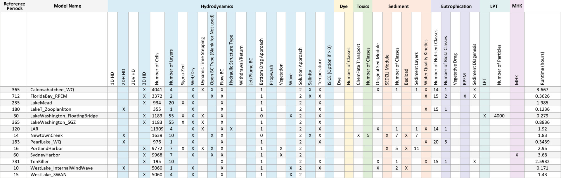

In contrast to most Tier 1 models, the Tier 2 models are more complex and help us provide better test coverage for how various components interact with one another over an extended period. While some of these models are available on our website, most were developed to support clients and are more specialized in the features they test for. The current list of Tier 2 models is provided in the table below.
Table 2. List of Tier 2 Models
