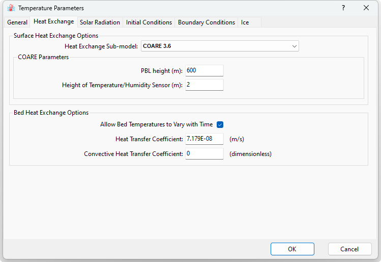

The EFDC+ Explorer graphic user interface has been updated to provide COARE 3.6 as an option for calculating water surface heat exchange. Figure 1 shows the setup of the COARE 3.6 option for surface heat exchange. The parameters include PBL height, which is set to as the default value, the height of the temperature/humidity sensor used for measurement, and the number of iterations of the COARE algorithm.
Figure 1. COARE 3.6 set up as a heat exchange sub-model.

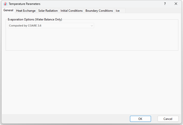

Users should note that when the COARE option is selected, the evaporation option will be switched directly to the COARE method, as shown in Figure 2.
Figure 2. Evaporation method following the COARE algorithm.
