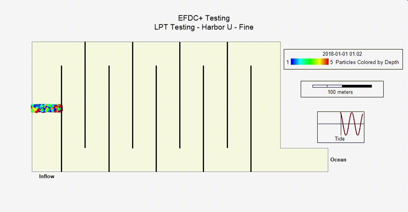

Verified Against Known Solutions
DSI calibrated the LPT module against an analytical solution for quasi-steady, uniform flow in an open channel, and tested it further across a range of hydrodynamic regimes and geometries. The module’s performance has since been demonstrated across a variety of applications.

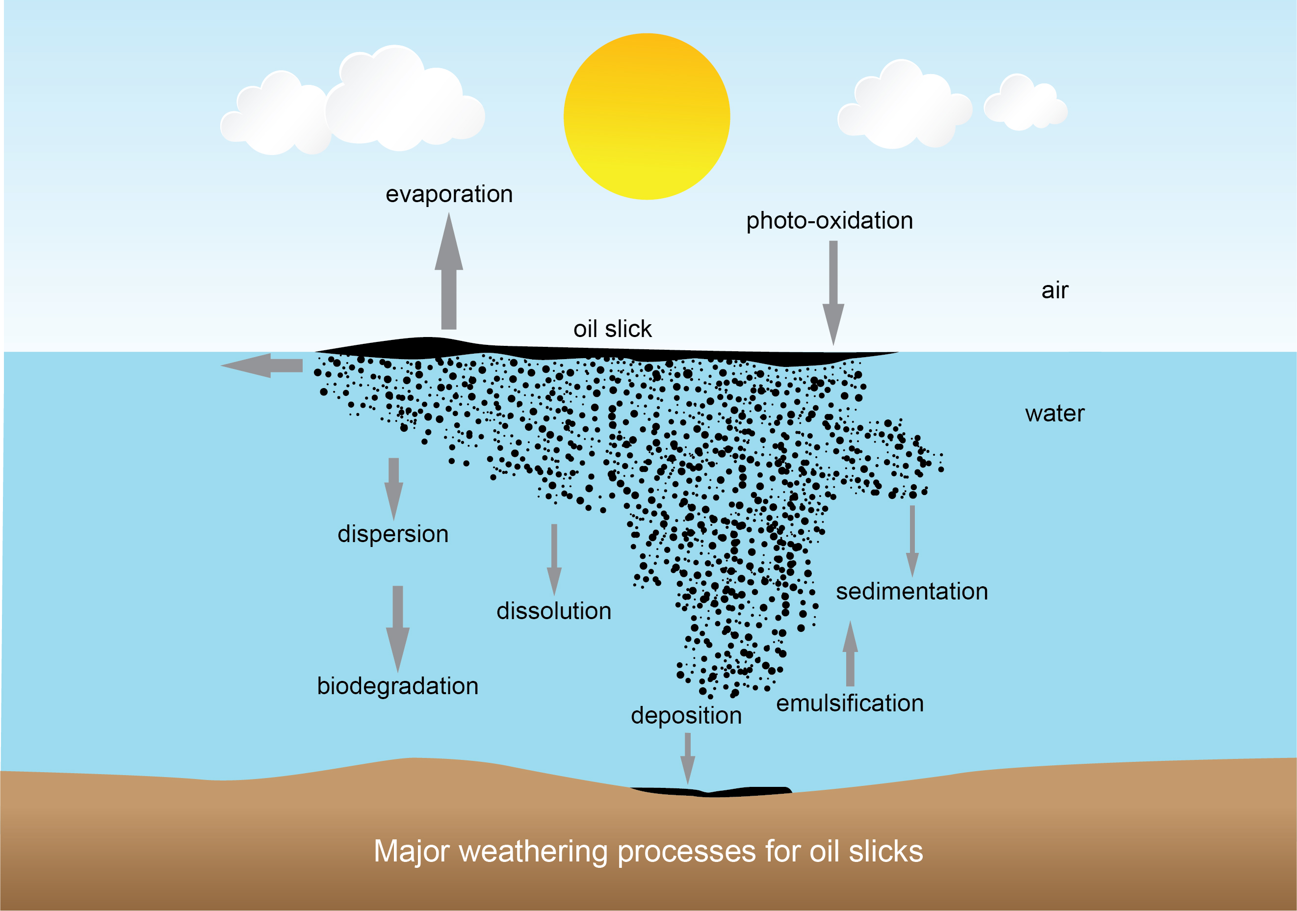

Major weathering processes acting on an oil slick: evaporation and photo-oxidation at the surface, and dispersion, dissolution, biodegradation, emulsification, sedimentation, and deposition in the water column and at the bed.
Figure 1 - Major weathering processes acting on an oil slick
