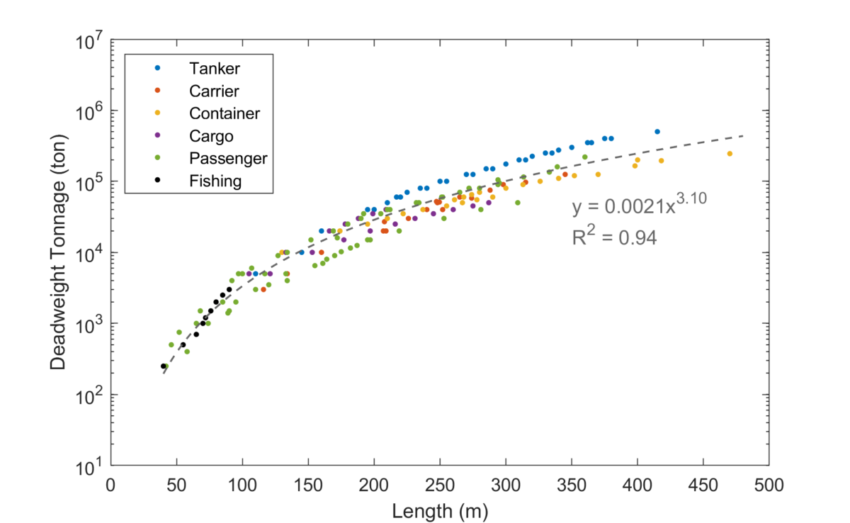

Figure 1 shows data from PIANC (2015) on the overall length and deadweight tonnage of various types of ships. The deadweight represents the ship’s loading capacity, including bunkers, fuel, lube oils, and other supplies necessary for the ship’s operation. With these datasets, the relationship between ship length L (m) and deadweight tonnage DWT (ton) is identified using the power function regression presented as Equation (1) for all vessels and for each vessel type separately and the coefficient values in Table 1:
DWT=aA~LbDWT = a × L^b

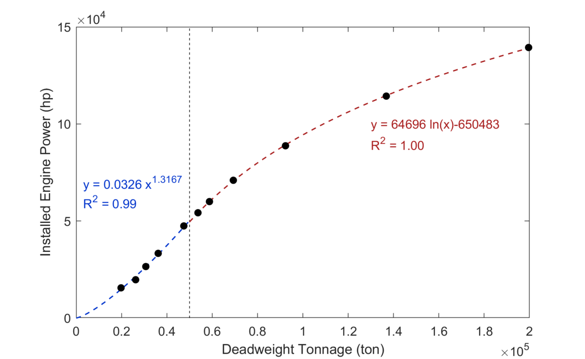

PIANC (2015) also includes samples that relate the installed engine power (hp) and deadweight tonnage at the design draft, as shown in Figure 2. A regression analysis defines the installed engine power P as a function of deadweight tonnage DWT for these samples. In this case, the relationship behaves differently when the deadweight tonnage is greater than 50,000 tons as compared to a deadweight tonnage of less than 50,000 tons, so that the different regression functions can be applied to each condition, as follows:
P={0.0326×DWT1.3167for DWT<50,000tons64,696×ln(DWT)650,483for DWT50,000tonsP = \begin{cases} 0.0326 \times DWT^{1.3167} & \text{for } DWT < 50,000 \, \mathrm{tons} \\ 64,696 \times \ln(DWT) - 650,483 & \text{for } DWT \geqslant 50,000 \, \mathrm{tons} \end{cases}
As a result of this analysis, modelers seeking to estimate missing ship engine power data can use Equation (1) to calculate the deadweight tonnage using the identified vessel type and length. They can then employ Equation (2) to estimate the installed engine power using the previously calculated deadweight tonnage.

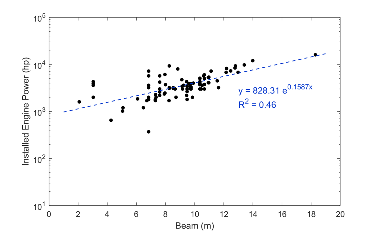

While this method is useful for larger vessels, the PIANC (2015) data does not include sufficient information for ships with a length of less than 50 m (see Figure 1). Typically, deadweight tonnage information is not available for such small vessels, so the approach suggested above might not apply to small tugboats, which usually have high engine powers to push or pull a barge. Tugboats may represent a large portion of ship traffic in harbor or bay areas. To fill the data gap, we collected 110 samples of ship dimensions and engine power for tugboats smaller than 50 m from TugboatInformation.com (2021). In Figure 3, the collected tugboat dataset indicates a positive correlation between installed engine power P (hp) and ship beam B (m), which can be expressed as the exponential function regression Equation (3). Therefore, modelers may employ this approach when estimating the installed engine power for such small-sized tugboats.
P=828.31×exp(0.1587×B)P = 828.31 \times \mathrm{exp}(0.1587 \times B)
