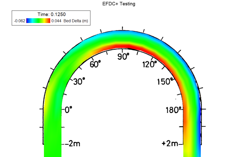

Model Name: TC-04_Yen&Lee_Sediment_7Across_E&H _Test_Case
Objective: Use EFDC+ Explorer (EE) and EFDC+ to simulate the test case described in the journal paper “Bed Topography and Sediment Sorting in Channel Bend with Unsteady Flow.” The measured data provided in the data folder can be used to compare sediment deposition from laboratory experiments (Yen & Lee, 1995) with the Engelund and Hansen option in the EFDC sediment model.
Model Grid: 301 horizontal grid cells, 4 vertical water column layers, and 8 sediment layers.
