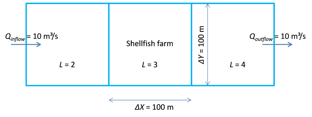

Figure 1. EEMS Model Domain for Shellfish Farm

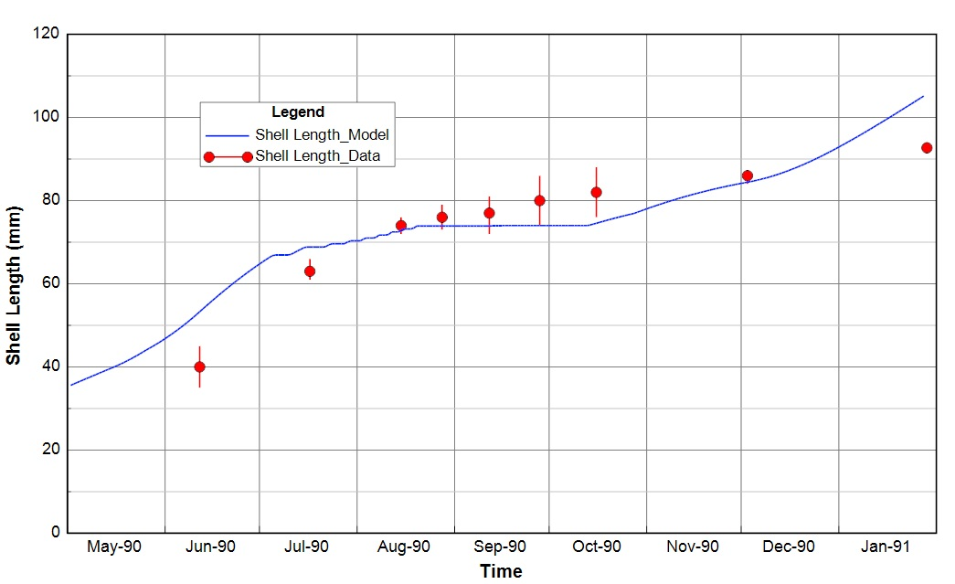

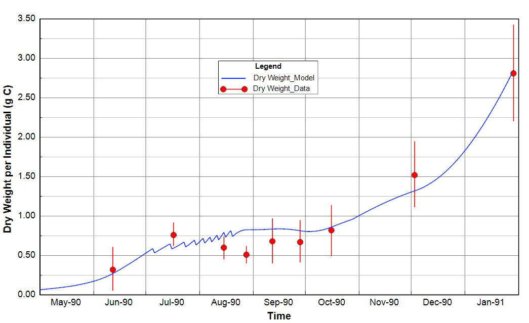

With a simple EFDC+ model comprising three horizontal grid cells and one vertical layer, DSI replicated the characteristics of the Hinase waters using the time series of salinity, temperature and chlorophyll-a measured by Kobayashi. Comparison of the measured results with the model simulation are shown below for shell length and dry weight per individual. It was found that EEMS matched the data well, as can be seen in the table of statistics. The model files will be provided for free download from our website after EEMS10.2 is released. The model can be run with the free demo version of EEMS. DSI welcomes feedback from users who try out this new module.

Mean ErrorRoot Mean Square ErrorCoefficient of Correlation
Shell Length-1.00 mm6.4 mm0.77
Dry Weight0.05 g C0.18 g C0.95
Figure 2. Time series of Shell Length
Figure 3. Time series of Dry Weight per Individual
