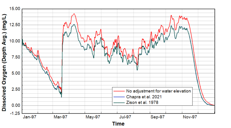

Figure 2. DO concentration in the middle of a high-elevation lake in North America.
To test the impact of these new options, we compared the options using a WQ simulation of a high-elevation lake in North America. The lake is situated approximately 1000 m (3,300 feet) above sea level, equivalent to a city such as Calgary in Alberta, Canada, or Salt Lake City, Utah. Three model simulations were run using the original Garcia and Gordon (1992) for DO saturation for the following cases:
  1. No adjustment for water elevation
  2. Chapra et al. (2021) adjustment for water elevation
  3. Zison et al. (1978) adjustment for water elevation
The results of the DO concentration at the middle of the lake for one year from January 15, 1997, to January 16, 1998, are shown in Figure 2. The elevation adjusted DO concentrations demonstrate a drop of approximately 1.5 mg/L from mid-March to mid-November, when compared to the modeled DO concentration without elevation adjustment. This result is explained as the impact of atmospheric pressure on DO saturation, which is lower due to the higher elevation. Overall there is no appreciable difference in the results using the two different elevation adjustment formulae described above.
In conclusion, the effect of atmospheric pressure on DO saturation at elevation is better represented in the upcoming EFDC+ version. This feature allows the models to consider more factors in the calculation of DO, especially for high elevation water bodies.
