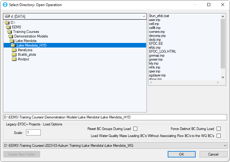

  1. Using the keyboard shortcut combination Ctrl + O to open the Directory window as in Figure 1.
Figure 1. Press Ctrl + O to open the Select Directory: Open Operation window

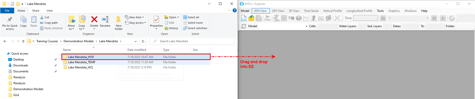

  1. Dragging and dropping project files into EE (Figure 2). The model folder (that contains all of the input files) dragged anywhere onto the EE start window will automatically be loaded. You can also load the entire model by dragging individual input files like inp, or any of the .ee files, onto EE.
Figure 2. Drag and drop project files into EE

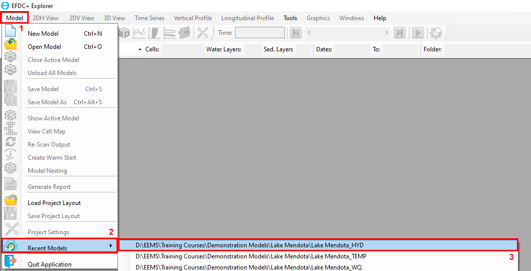

  1. Accessing recently opened projects by selecting Mode > Recent Models in the Main Menu:
Figure 3. Open recent models in EE
