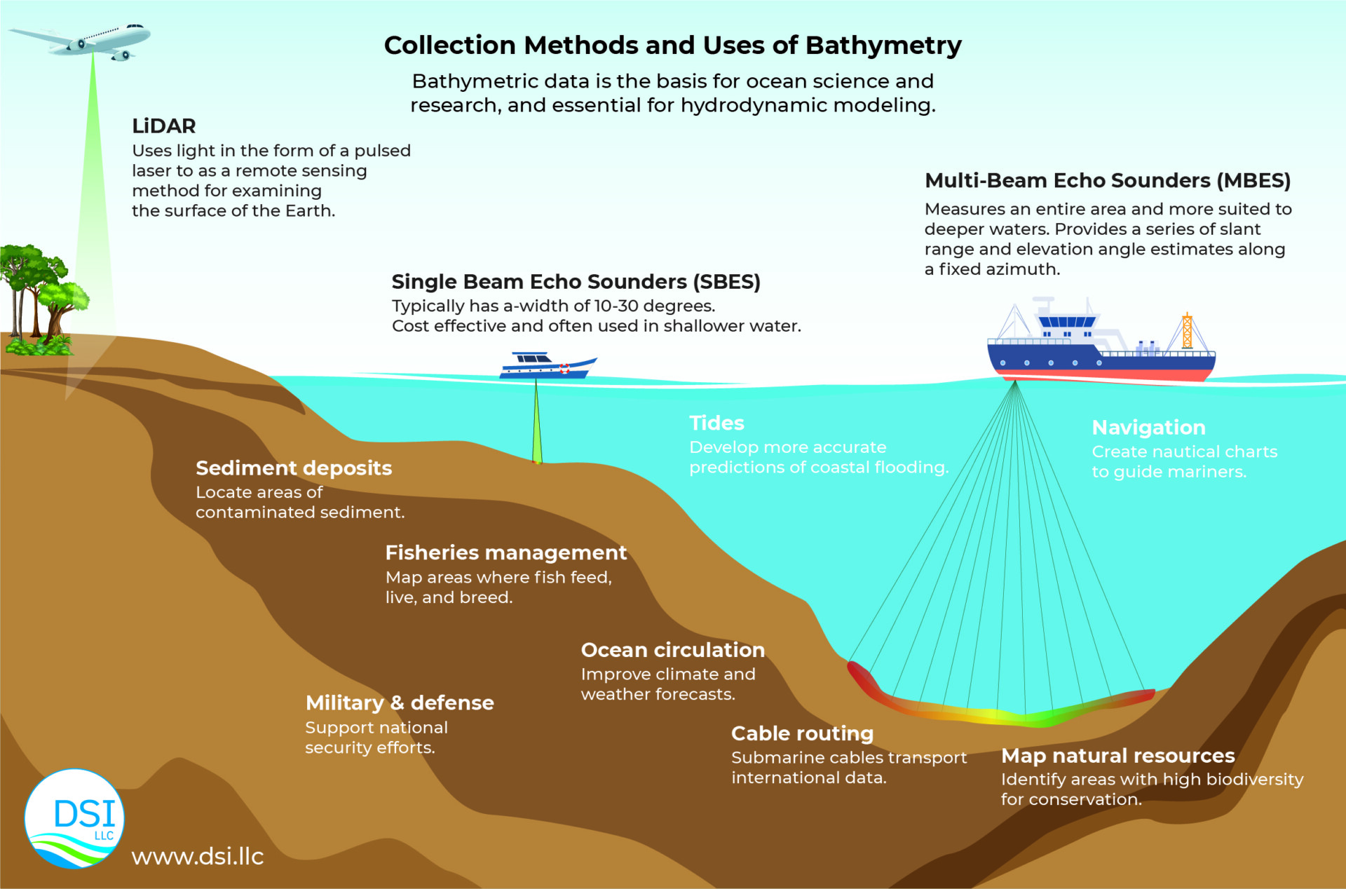

Bathymetry is the study of underwater depths in lakes, rivers, and estuaries. It is crucial for understanding the underwater terrain of a water body, and it serves multiple purposes, including water resource management, navigation, engineering, and environmental monitoring. Detailed maps of underwater topography are essential for understanding how variations in depth influence water flow, sediment transport, and ecological habitats. This data is critical for predicting a waterbody’s responses to environmental stresses such as floods, sediment accumulation, and the impact of human activities like dam operations.
Figure 1. Some of the many uses of bathymetry.

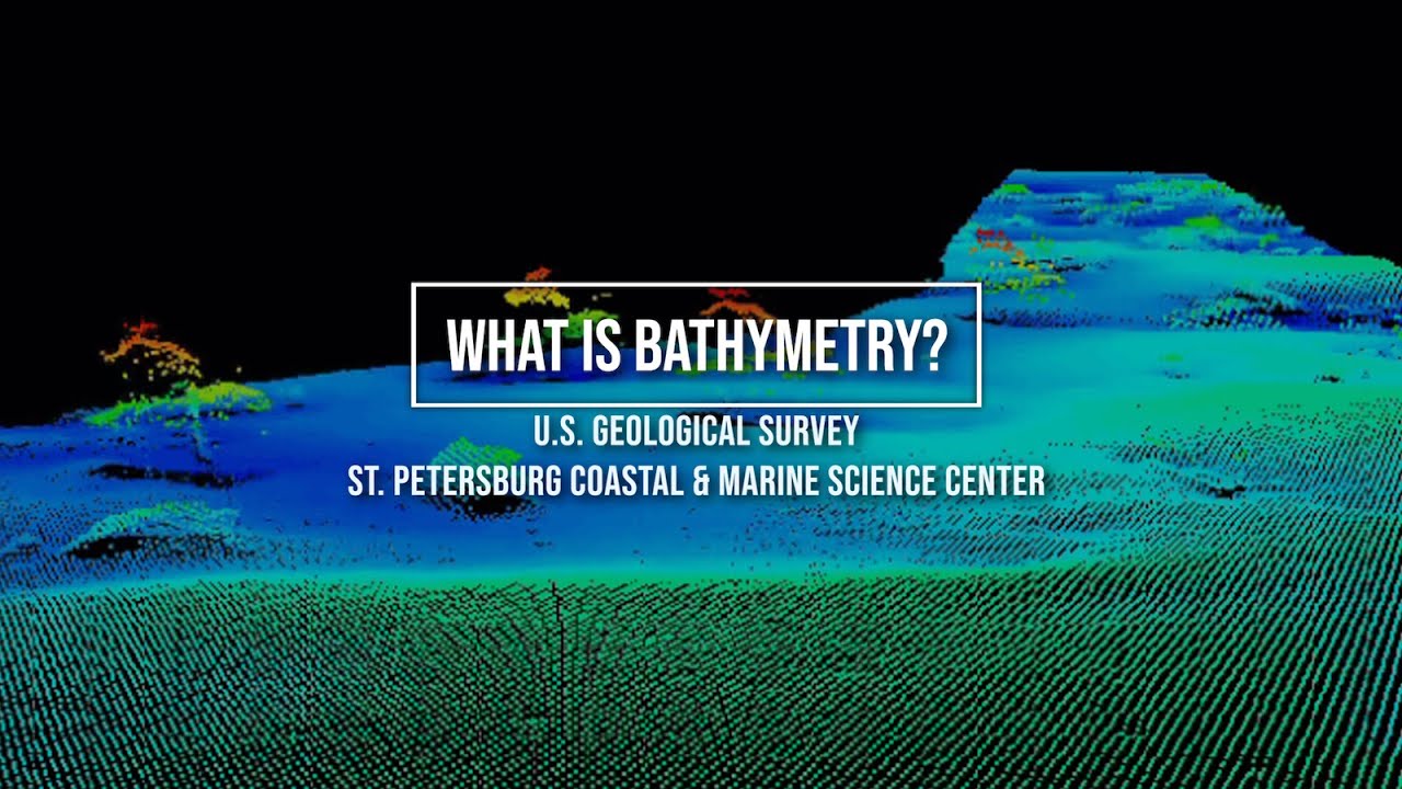

Beyond simple mapping, by comparing bathymetric information from the same location at different times (e.g., across multiple years), it is possible to quantitatively assess elevation changes in the riverbed, identifying patterns of erosion and deposition in a given period. Such analyses are invaluable for understanding sediment dynamics and informing targeted management strategies for sediment-related issues. Advanced technologies like multi-beam sonar can be employed to collect detailed bathymetric data. This facilitates the creation of accurate datasets reflecting the morphology of the waterbody bottom topography. Multi-beam, single-beam, and Lidar can be merged into comprehensive floodplain, nearshore, and deep-water topography. These data support various waterbody management activities, including dredging, habitat restoration, and flood management (Smith, 2017).
USGS provides this helpful video to explain how bathymetric data is acquired.

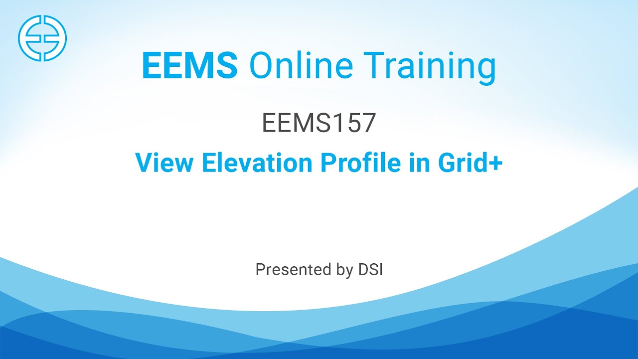

The grid must be sufficiently refined, so that it is coarse enough to run in a reasonable time, and fine enough to provide answers to the questions that will be asked of the model. Preparation of the bathymetric data for the building of model involves a number of steps as outlined below:
  • Data Cleaning: After receiving raw data, it is processed to remove any noise or errors. This may involve filtering out outliers, correcting for sound velocity variations, and compensating for tidal effects, and identifying and filling data gaps to ensure a continuous and accurate dataset.
  • Data Validation: The processed data is checked for accuracy and completeness. This may involve comparing it with known benchmarks or conducting additional surveys in areas with poor data coverage.
  • Data Visualization: The bathymetric surface is visualized using software tools such as Grid+ and EFDC+ Explorer that generate 2D maps or 3D models of the seafloor. These visualizations help in understanding the underwater terrain and identifying features like ridges, valleys, and structures.
  • Data Reduction: Large datasets are often reduced to a manageable size while preserving important features. Techniques like interpolation or data thinning are used.
  • Data Interpolation: To create a continuous surface, the discrete data points are interpolated as appropriate for that final grid. The grid will be generated using a tool such as Grid+. Common interpolation methods include kriging, inverse distance weighting, and splines.
This video shows how to add bathymetric data to a grid to develop an EFDC+ model.

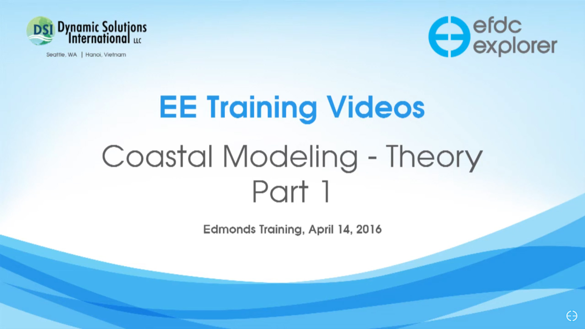

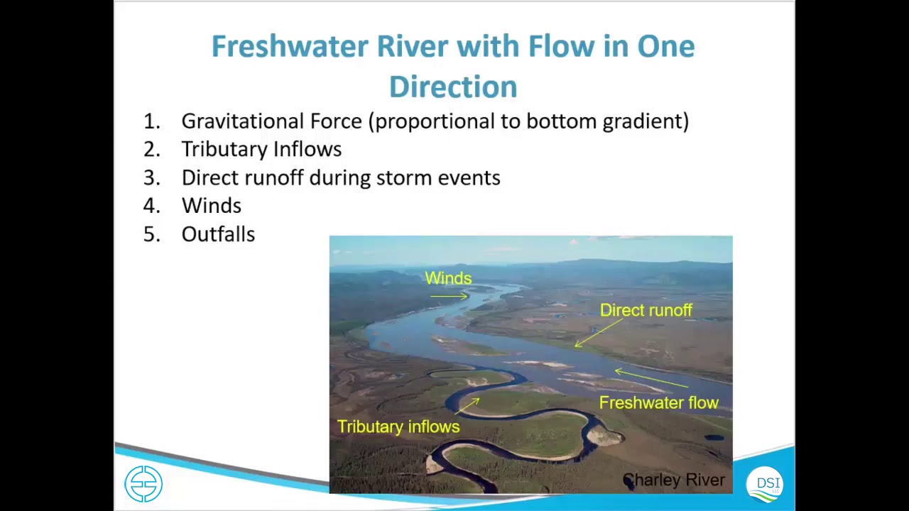

It is important to follow a standard process in developing a hydrodynamic model. We have a checklist we often use. Furthermore, DSI have developed several training videos which provide insight into how to develop such models.
This training video focuses particularly on coastal models.
